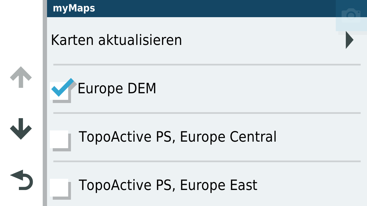

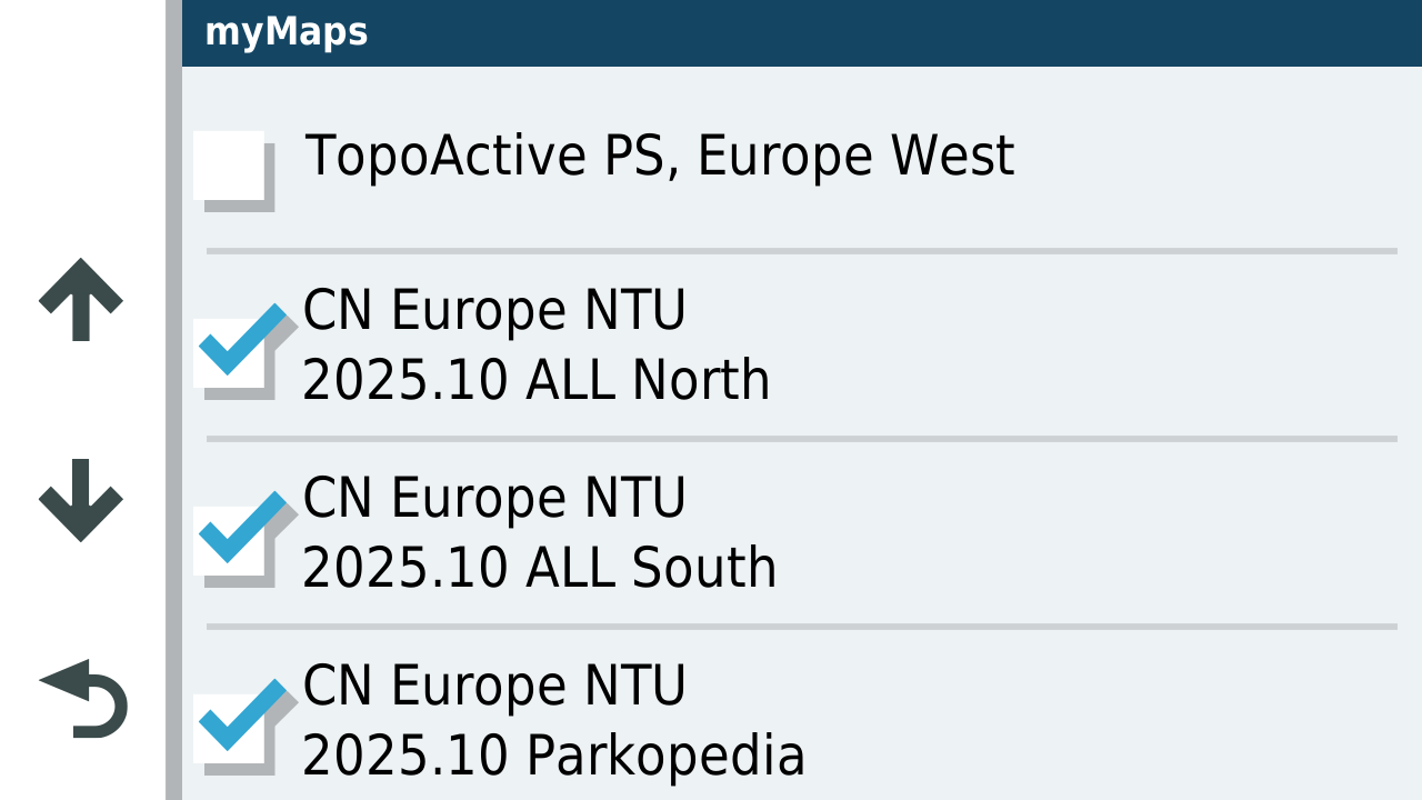

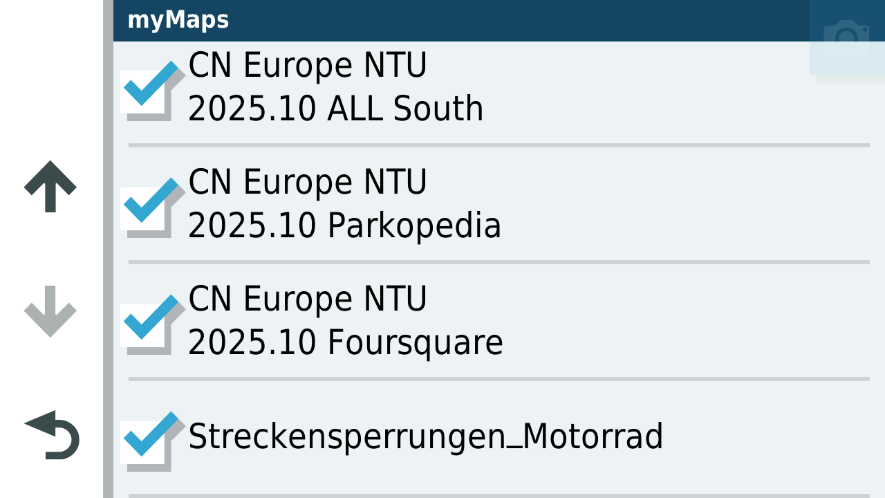

A 'standard' map installation on a european Zumo XT will look like as follows:
It makes no difference, if the three TopoActive maps are selected or not - if you don't drive offroad, you can disable them - also the last entry (Streckensperrungen_Motorrad) is installed by me and marks some road-blocks for motorcycles here in central europe. The other entrys (Europe DEM, CN Europe NTU All North & All South) should be selected. CN Europe NTU Parkopedia and Foursquare are just POIs and can or cannot be select - just as you like.
As i said before - if you not get speed limits on bigger (main) streets, there is definitively something wrong! This could be the maps or your Zumo XT. You should install the whole maps again with Garmin Express and test it than. If that doesn't work, make a complete reset of the Zumo XT and check again!
Bye, Robert :)
