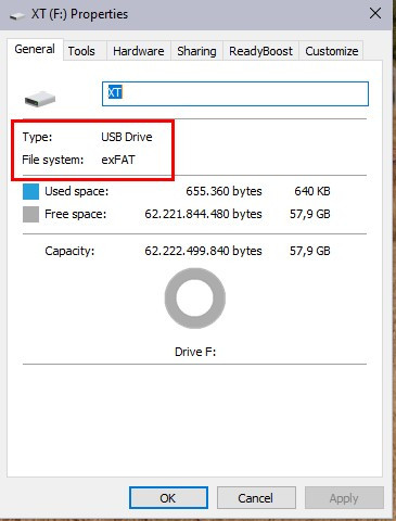

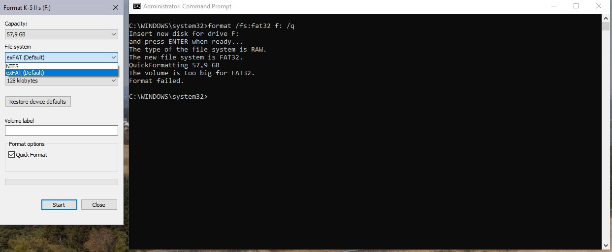

First 2 screenshots of the 'standard windows' method, this way the card will not be recognized by the XT
Right-click on the drive and select 'format'. Notice the option 'fat32' is NOT there. If you use the commandline it will tell you the drive is too large.
If you go ahead and format, and afterwards you right-click on the drive and choose properties, it it still 'exfat'

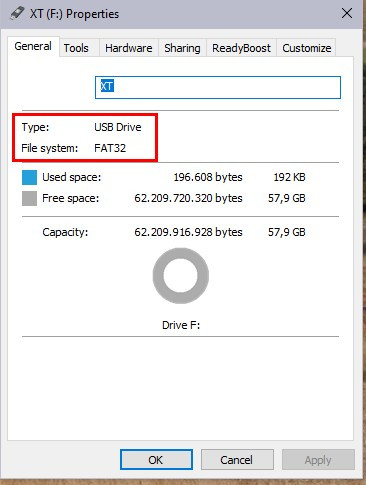

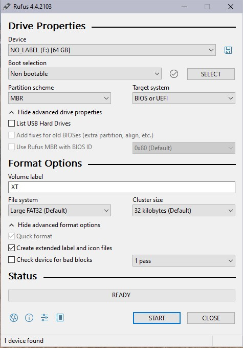

If you use a 3rd party utility like rufus https://rufus.ie/en/ (but others may work also) and fill out the form like this:
Then it will show 'fat32' afterwards. And the card should be recognized.
