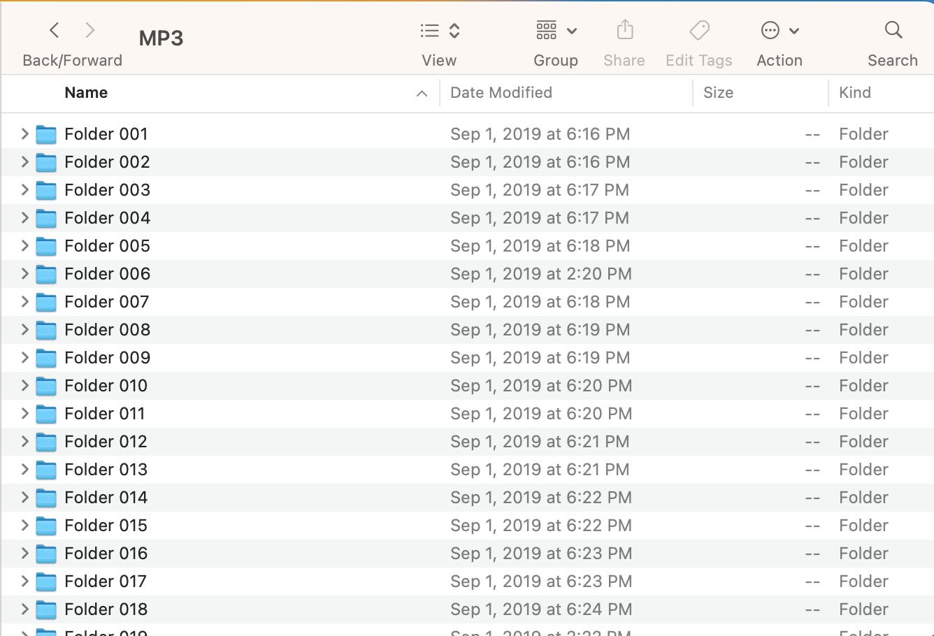

I can tell you the following. I have both a Zumo 550, 660 and a 665. On all of the units the "Music" files are stored in a folder on the SD Card named MP3. I just took a screen shot of the storage on the 665 and 660. Here is the shot. Cann't seem to post it as I expected.
- Screenshot 2024-01-17 at 3.46.40 PM.png (229.48 KiB) Viewed 6283 times
