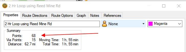

I know what "Points" he is referring to.
Regarding the problem, it has been awhile since I have transferred a route to my XT using the Drive app but, IIRC, it still goes through the XT's import process before it shows up in Trip Planner. Is the import process completing normally? If the route never seems to arrive in the XT will a re-transfer work?
Re: Problem uploading a specific route to Zumo XT
^^^ Yes, that's the "points" I was referring to. Don't know what it really means, but I guess it's some sort of measure of complexity...
