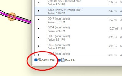

There a couple points here that may not affect the "cannot calculate" problem, but I think should still be clarified, even though it is probably all old news to the regulars here.
The XT will split a route with too many via points into separate routes of 30 or less via points. There is also a maximum of 125 shaping points allowed between any two via points. I have no idea what the XT will do if you give it a route with more than that because I've never needed more than a dozen or so between two via points to pin a route in place, even on a section using multiple roads.
When checking point placement, be sure the "Center Map" box is checked after opening the route. Then, as you click each point in the list, the map will automatically pan and zoom to an appropriate level while highlighting the point, making it quick and easy to verify that the point is on the road.
The route summary in Basecamp combines via and shaping points and reports the total as via points, which can cause confusion. This route actually has six via points and 18 shaping points:
(I have no clue what the 96 "Points" represent)
