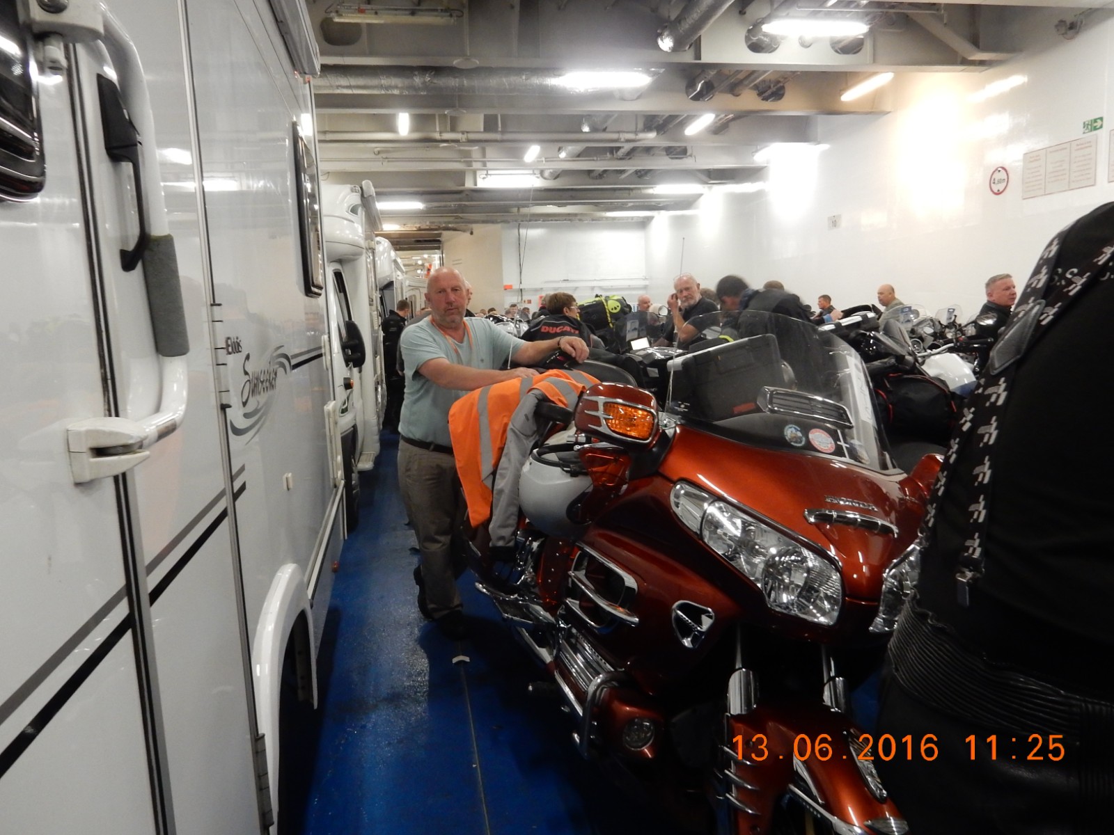

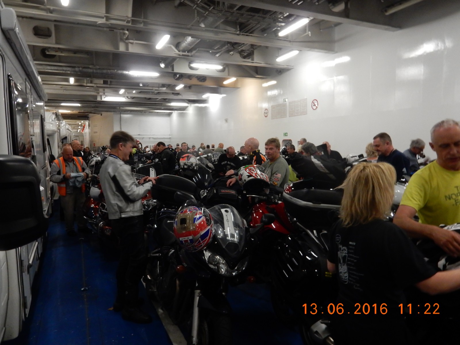

I've taken my '07 Wing on a good many ferry journeys, always to France or Spain from the UK. Here, the ferry company straps the bike across the seat (concerning if you have heated seats but never been a problem with mine) I always take a towel to cover the seat before they put their (often oily/greasy) pad on the seat. As @jfheath says, always on side/kick stand, in 1st gear and I also put a cable /zip tie on the front brake just for extra insurance.Peobody wrote: Mon Oct 16, 2023 12:10 am My upcoming trip includes three ferries. I have never taken a motorcycle on a ferry so would appreciate advice on what to expect and how best to secure the bike (2008 Goldwing). For anyone in the U.S., these ferries are on the southeastern coast: Southport to Fort Fisher, Cedar Island to Ocracoke, Ocracoke to Hatteras.
I hope your ferry company treat you rather better than Brittany Ferries treat bikers here!!

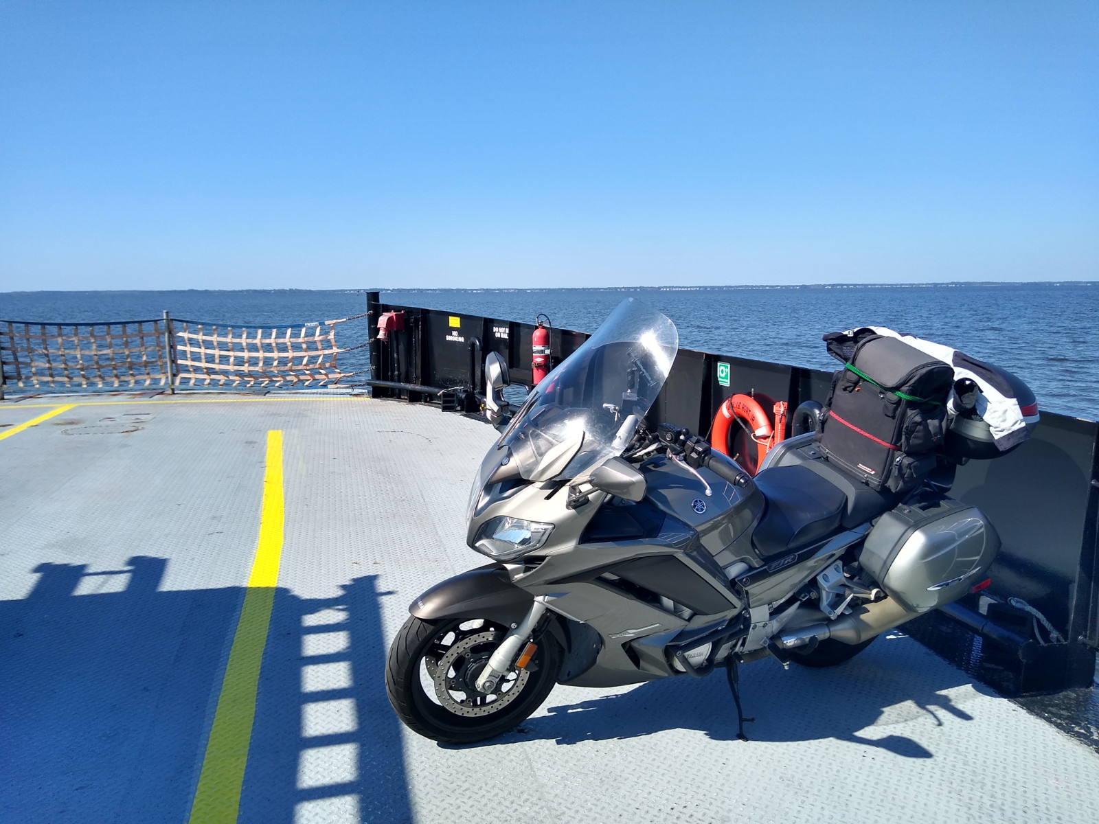

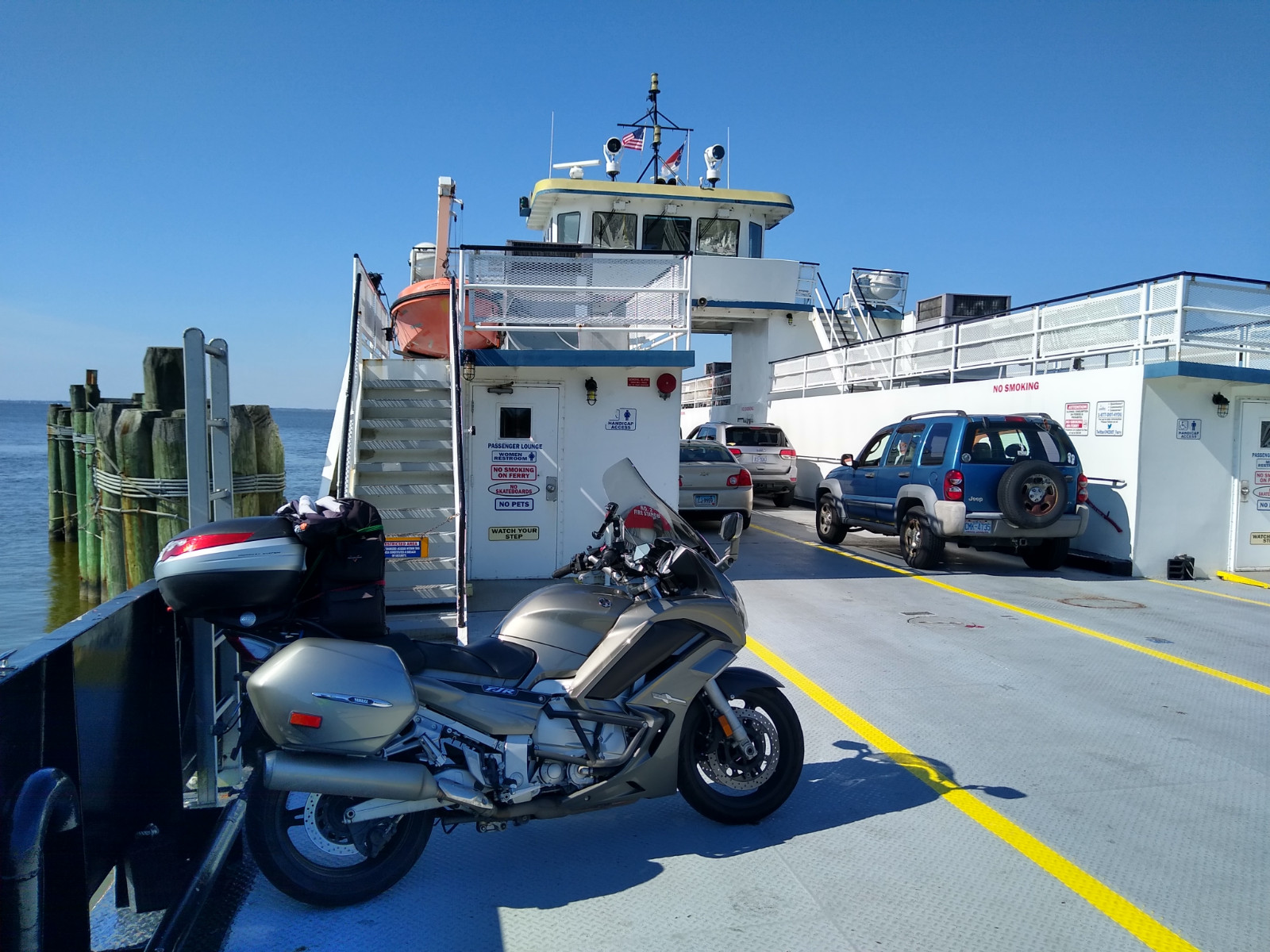

I have taken my bikes on all the NC ferries you mention plus a few others in NC & MD. The biggest things about the relatively small ferries we have:
You will generally be asked to embark last and pull off to the side. On the big GW with reverse it's no big deal but I have to pay close attention to how the deck slopes or I may need help backing it out. Often I pull in and swing round to back the rear tire in rather than pulling the front tire in.
I've never had the need to secure the bike. Nor have I had the need to use a center stand. The side stand in first gear on a slope is more than adequate even in 4-5 ft seas with "a 38 nor-easter" wind. I have been asked to stay with the bike until turns are completed and until "we see how it's effected". Most of the time I plop my butt on the seat on the side opposite the side stand. I've never had to remain that way long at all. This is the Knott's Island-Currituck ferry, typical of all the NC ferry's layout.
