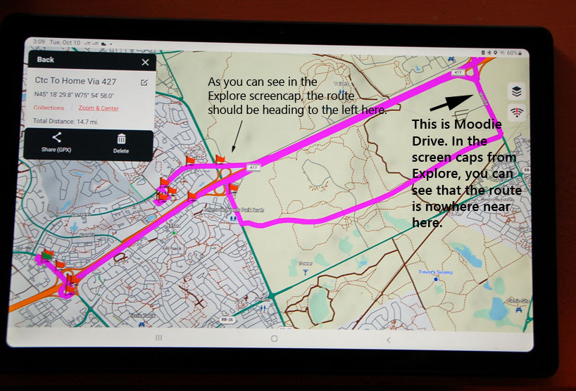

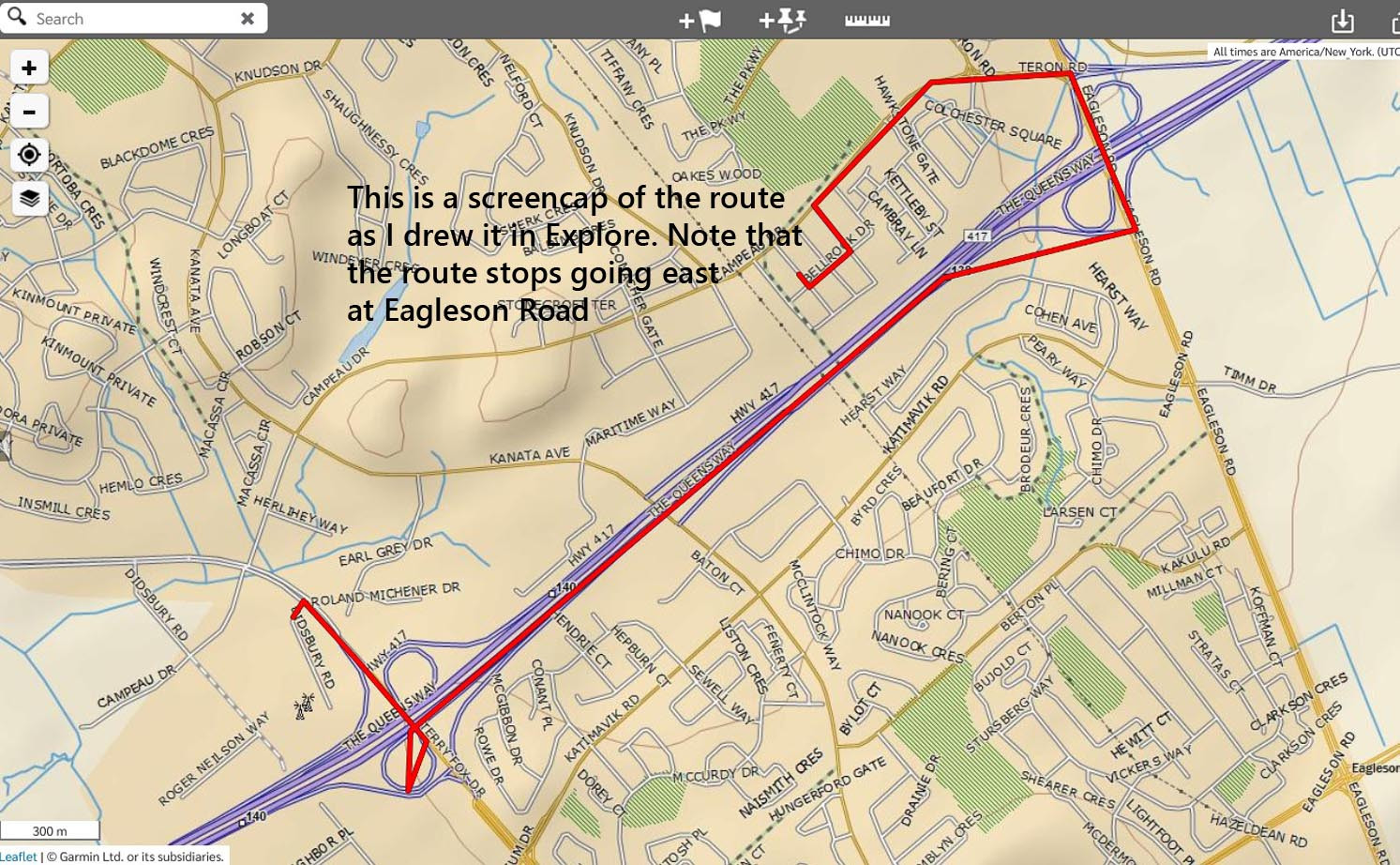

Garmin tech has written me again. (I have to hand it to the guy. He does not give up.)
I had sent him a screen cap of a route that I made in Explore on my PC. I had sent him a pic of that same route after it was brought into the Tread app. (Just an FYI, there is no Tread app for the PC. That would make creating routes far too easy.) The two pics were very, very different. In short, the route that I created in Explore left a gas station, entered a highway going east, followed that highway to the first exit, headed north from that exit, west at the first local street and two more lefts to my house. Here is a screencap of that route in Explore
Now here is that same route in Tread. You can see that the route no longer exits at the first exit - Eagleson. It continues on to the Moodie exit, then heads west through a very convolute way back to my house.
So I sent Garmin these graphics. I also sent the .gpx file from Explore and the .gpx file from Tread. Garmin tech's reply was that the .gpx files were exactly the same. I can only conclude, then, that Explore interprets the .gpx file one way and Tread interprets it completely differently. He did send a new .gpx file showing me what I did in Explore that made Tread do what it did. In short, he has me leaving the highway before the ramp; in effect, into a field.Then, doing the same thing leaving the ramp onto the northbound road. He really does not want me to use Explore at all, though.
I really believe now that the way forward, assuming for the moment that I'm going to go forward and not simply return the Zumo, is to go back to BC and play until I get it to work. Some day, Tread may be ready for prime time, but it sure as hell is not now.
