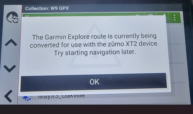

Now the fun starts. My wife has the same unit, same software, same Tread app, and same MAP. Luckily enough we have comms or else one of us would still be stuck in Wayne National Forest somewhere in Ohio. She asks inquisitively "Weren't we supposed to turn RIGHT back there?", to which I respond "No, the map has me going straight", to which she responds "That's not what mine says!". Good times, thanks Garmin for the memories (and where do I send the marriage counseling bills?).
Tread App Needs Data to work / sync
So her unit and my unit are out of sync (I assume) because we're both working to the same input (either BaseCamp or .GPX file). Let's see if we can't fix this. As stated previously, we're in the middle of some National Forest in Ohio, cell service isn't great if any at all. I can share the file via Bluetooth to her phone, she can then bring it into her Tread App, and then her unit can sync and we're good to go! NO SO FAST says some Garmin Engineer who obviously doesn't ride... You need CELL SERVICE for the Tread App because until we do our little magic on your phone, we're not going to sync with the unit. Fan F@ckin Tastic!

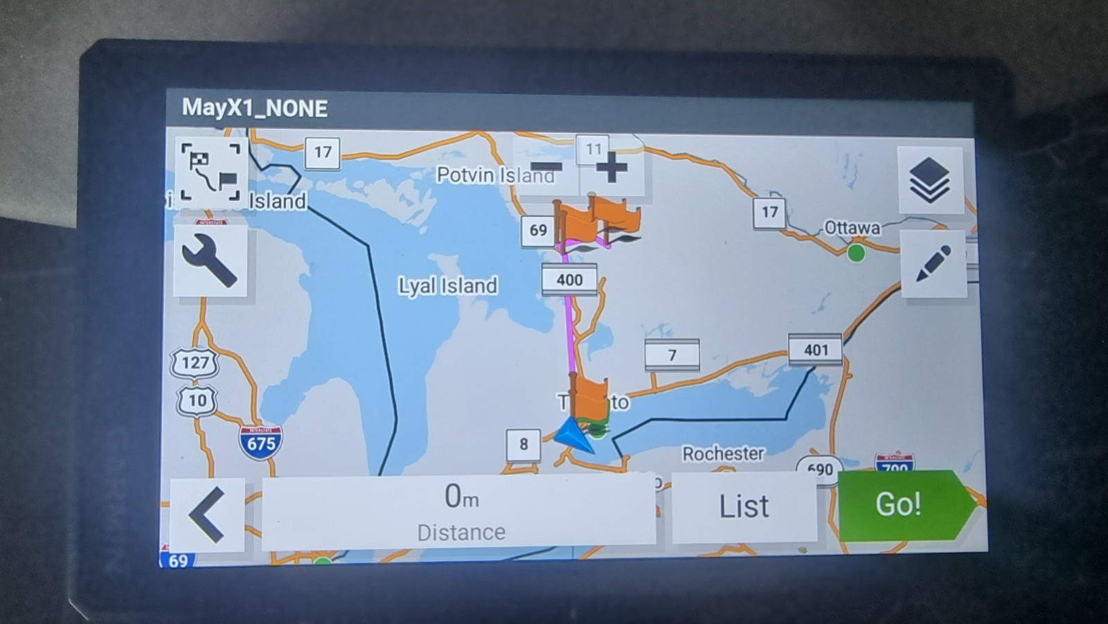

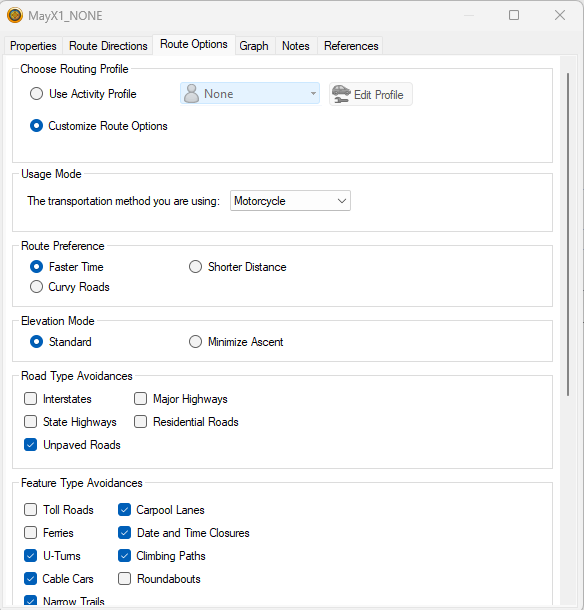

Some further experiments, because I (the user) should try to figure out the workarounds to use this $1000 CAD unit.
Went back into BaseCamp, set the route profile to NONE. This takes the route and assigns CUSTOM ROUTE OPTIONS Scenario 1 - BaseCamp EXPORT .GPX to Tread App, import into Tread, Calculate, Sync to ZUMO XT2
Route 1
BaseCamp - Route says 333km 4h14m NEW 272km (not expecting this to be accurate as it is point to point)
Tread App - Route says 333km 3h39m NEW 333km 3h39m SAME
Zumo XT2 - Route says 333km 3h40 NEW 333km 3h40m SAME

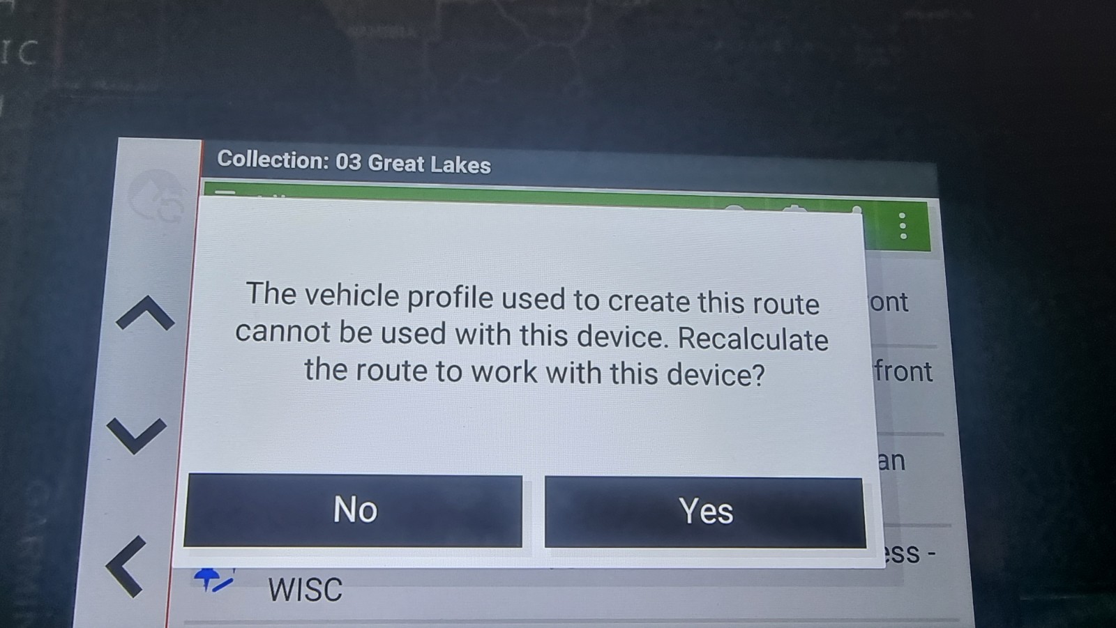

Scenario 2 - BaseCamp EXPORT to ZUMO XT2 via BaseCamp and import into unit bypassing Tread App
IT DOES NOT LIKE THIS AT ALL!!!!
I got this on my unit... pretty much a non-starter.

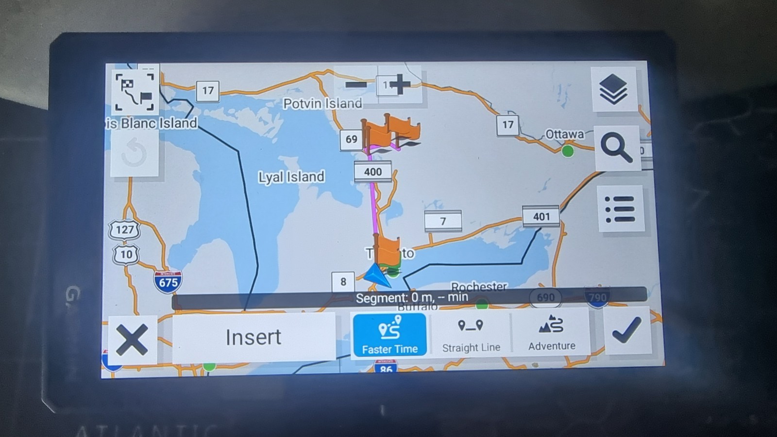

On the XT there is a button on the map that allows you to skip a point. You may have to turn it on. To do so, view the map, tap the three-dot button, then the spanner button (wrench). This will open the Map Buttons options screen. There are three positions where you can select a specific function button. Any "Plus" button is a location where you can add a function. You can change one by trashing it and then adding a different one in its place. The "Skip" option is the one that creates a button allowing you to skip the next point. Hopefully the XT2 has this same functionality.technoguppy wrote: Tue Jul 18, 2023 3:09 pm There used to be a pop-up on the 595 and 660 "Skip this waypoint" when it tried to reroute you back to your route. Haven't seen that pop up on my the ZUMO XT2 yet.

Just a note about Basecamp profiles - mentioned a couple fo posts ago.
None of the information that you set about avoidances in the BC profile is transmitted to the XT. None of it.
The only information that is transmitted is :-
1) the activity profile name - Driving/Motorcycling - which convertes to Car / Motorcycle in the XT
2) Faster Time / Shorter Distance
3) Direct Profile - which sets the XT to use Straight Lines.
If any other profile name is used, (like Custom profile in Basecamp, or none from any other program) , then the XT defaults to using Motorcycle.
If any other routing preference is used (like Curvy Roads in Basecamp), the XT defaults to using Faster time.
It may then cause the route to recalculate and if you have any of the other options ticked, then the route may differ wildy fromt he one that was created by BC.
If you want to know more about this behaviour on the XT, then I did a fairly complete summary in this section and following pages here.
But it is really tedious stuff to get your head round.
app.php/ZXT-P38
However custom profiles have a really useful feature. When you change any of the preferences, the results are changed on the route instantly, and the changes do not affect any other route. So it is useful for placing route points to manually avoid motorways, ferries, major roads etc so that you can then rmeove the avoidance to see instantly whether or not the orute changes. Then change the profile back to Motorcycle.
app.php/ZXT-P38

It is dissapointing to hear that all the bad XT routing behaviours are also present in the XT2 (which is not surpising by any means).
Honestly there is no compeling reason to upgrade.
