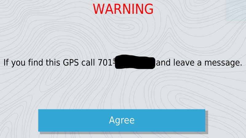

I also could not find an American English language file in the Zumo XT text folder.
I edited the en_GB.glx file removing the original Warning screen text and added my contact info.
With American English selected for Text Language it displayed the Garmin's warning text.
When I switched the language to British English it displayed my contact info as shown in attached photo.
It appears British and American English have separate .glx files contrary to thoughts in a previous post.
If anyone knows the American English file name let me know.
screenshot capture
Zumo warning screen.jpg (66.12 KiB) Viewed 1288 times

Re: Customising the warning screen
American English and American Text/Keyboard are hard coded into Garmin devices I believe, prevents them being completely useless if a user somehow deletes all languages etc.
You won't therefore find separate files.

keyboard has an editable file...en_US.kbd in keyboards folder
Thanks for clarifying. Must be the text that is hard coded then.
