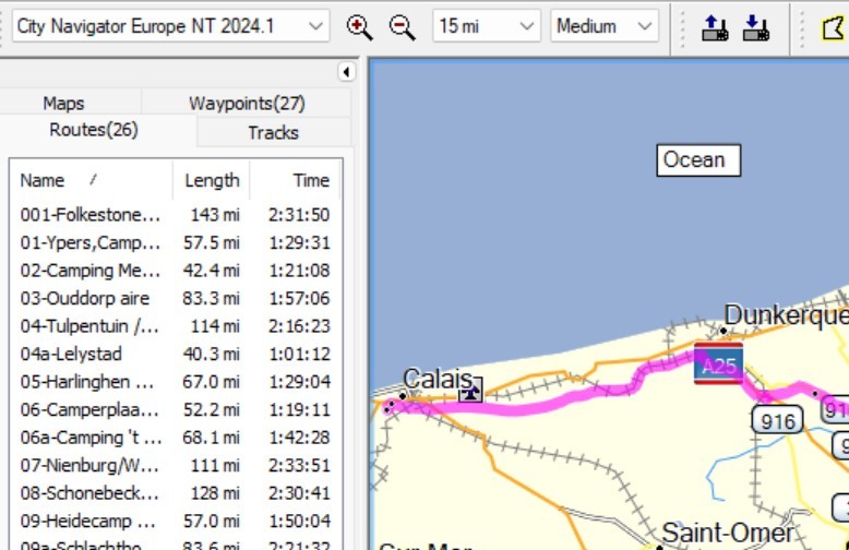

Just loaded Mapsource without any problems. I notice that the Map pane on the left-hand side is empty, is that usual? I read somewhere that you can't load maps from the device unlike for Basecamp, I guess that is linked? Did a transfer from the device to Mapsource though and it loaded some old, very old tracks!

I have both Basecamp and Mapsource installed. If you install the map to the default directory on your computer, then both Basecamp and Mapsource can see the same map.
The map tab of the left hand window is empty on my version of mapsource. The drop down list ont he menu shows that it is using 2.24.1 at present, although 3 other maps are still available for me to select.
Re: Dusted off the 660.
The map pane will fill up as you create routes.ScramblerChris wrote: Thu Jun 29, 2023 12:13 pm I notice that the Map pane on the left-hand side is empty, is that usual?

After your previous posts I looked at Mapsource (I always use BC now for route planning) I was interested to see that the latest map was available on there- NT2024.1 which I'd recently downloaded to my PC and 660 as @jfheath pointed out.

All map updates are available on Mapsource and always have been. See my picture abovekernowing wrote: Fri Jun 30, 2023 7:48 am I was interested to see that the latest map was available on there- NT2024.1 which I'd recently downloaded to my PC and 660 as @jfheath pointed out.
