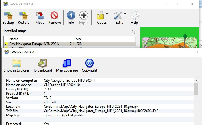

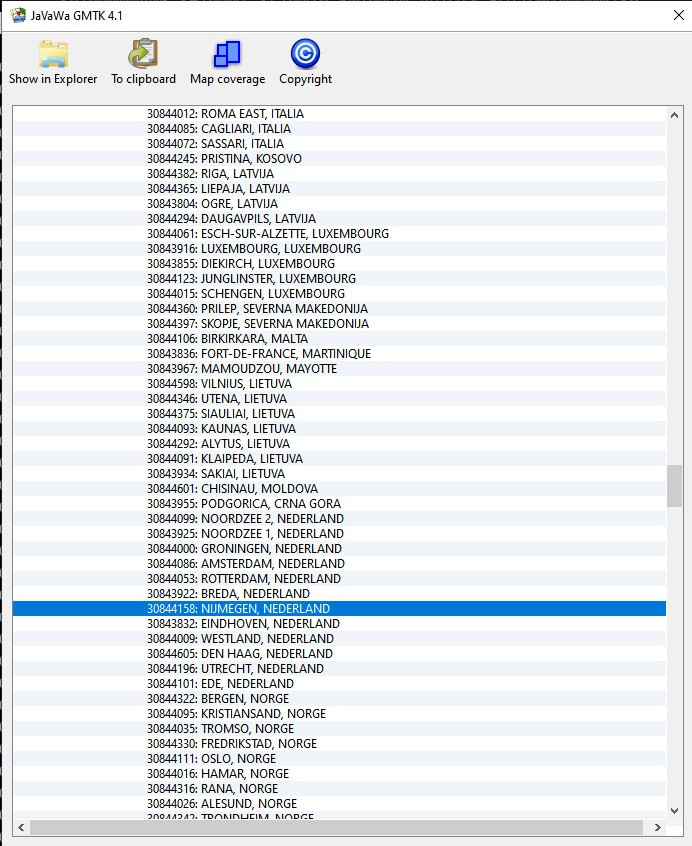

Every route in BC has references to the map for which it was calculated. It may not be obvious when you look at the GPX file, but it is there in the <subclass> field. The hexadecimal number 0600FEA4D601110F1200211600000C001500 in the sample contains the Map Segment number. If you install a new map in BC and recalculate, this number is changed to point to the new map segment number. If the route in your XT no longer matches the installed map, you need to recalculate it. For the XT to operate correctly, the Subclass field should be valid!

FEA4D601 => 01 D6 A4 FE => 30844158 is the map segment nbr '30844158: NIJMEGEN, NEDERLAND' belonging to City Navigator Europe NTU 2024.1.
See the screenshots made with Javawa GMTK, they will confirm that.
Long story short: Always recalculate your routes after you installed a new map. The roads may not have changed, but the map segment numbers will.
