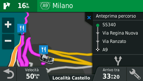

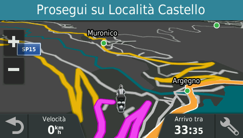

hello all,
I can't make my zumo be useful.
I'm trying to make it display indications and prompts for voice directions but when I start a new trip I get only one voice indication (and some other useless alerts (loss satellite signal...)) and nothing else.
I miss also the next turn distance and info.
The strange thing is that it works when I enable "simulate GPS indoor" and start a trip allowing to simulate the real trip. In this case voice indications are complete, along with turns indications.
I already resetted zumo to factory settings and removed all but default maps.
But nothing changes.
What am I missing here?
TIA for any help.
