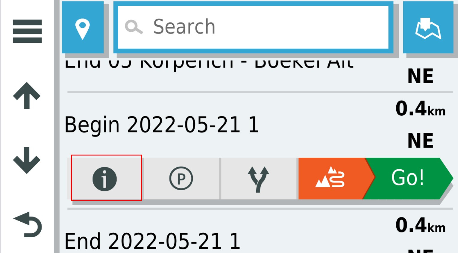

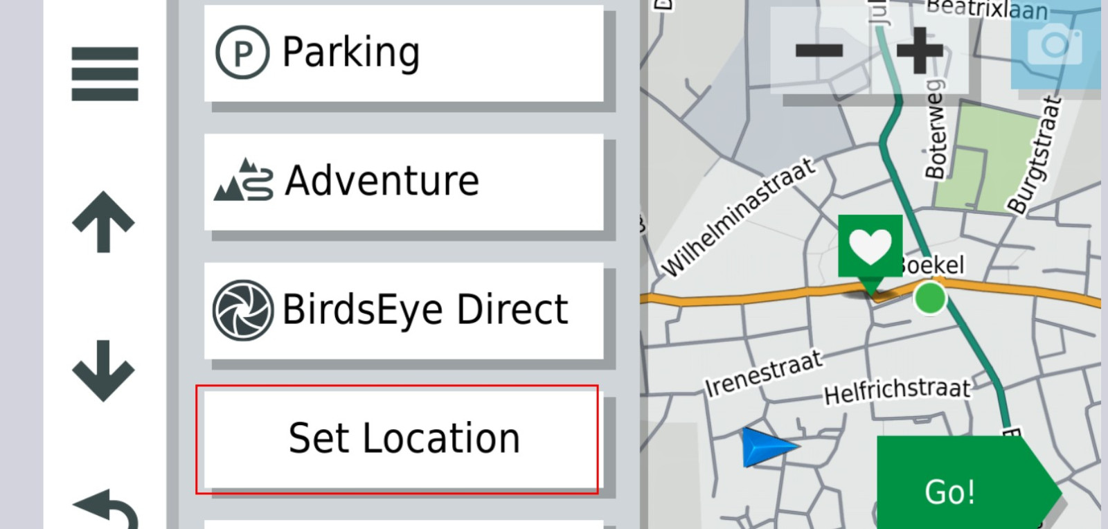

I know 2 methods to do this. There may be more, but for me it's enough.
1) Open a Saved location (Where to/Saved), Click on the I Symbol of the location you want.
CLick on 'Set location'
2) From the Map. First Click on a road or point.
Cick on the name of selected road/point (Nieuwedijk 15 in the screenshot)
Click on 'Set Location'
Note: The button 'Set Location' appears only when you've enabled the GPS Simulator

Thanks @FrankB. That "Set Location" option is what I couldn't remember.
