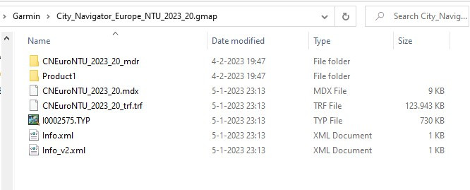

How does the folder look when you open it? The Info.XML file should be there, and in the Product1 subfolder you should see a lot of subfolders.

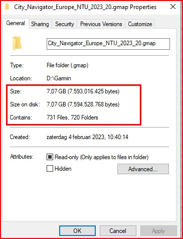

Check the properties.
What is you Mapsource version? I have 6.15.6 and that opens the map if it's in the programdata folder.
I suggest you try JaVaWa GMTK, has worked for me.
https://www.javawa.nl/gmtk_en.html

FrankB, everything looks very similar to yours:
I was wondering if editing regedit or moving the location of the gmap file would help?
