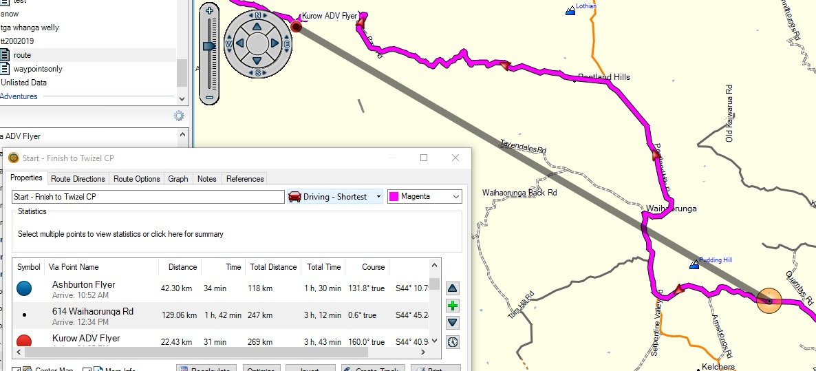

make sure your avoidances align with what you want.If it wont take the road you may need to put in a shaping point or three.When you insert those points and they show up in the route box there is some way to turn off alerts
Re: First question
If you're able to post a screenshot and say where it is we should be able to explain why. I've never come across a situation where BaseCamp routing however weird can't be explained.

sussamb wrote: Sun Sep 02, 2018 9:43 am If you're able to post a screenshot and say where it is we should be able to explain why. I've never come across a situation where BaseCamp routing however weird can't be explained.
really ! i find it not logical at all sometimes it will put in a big loop to avoid the road i want to go down.and i cant see that avoidances,distance or time is any more the way i want to go.I am sure there must be some logic.I think the whole thing has become far to specific. should ony be a couple of avoidances IMHO

You can create your own profiles, so just create one with the avoidances etc you want.

advnzer wrote: Sun Sep 02, 2018 9:47 am really ! i find it not logical at all sometimes it will put in a big loop to avoid the road i want to go down.and i cant see that avoidances,distance or time is any more the way i want to go.I am sure there must be some logic.I think the whole thing has become far to specific. should ony be a couple of avoidances IMHO
If it makes you feel better- it's not just you. Base Camp does it to me occasionally. There's still a section of road about 1/2 mile long that I travel every other day that BaseCamp will do whatever it can to avoid. I never have figured out why but it's like it thinks the road is closed for construction. Even if I put 6 shaping points in 600 yds it simply will not route down that section. I've used Garmin Express to report this several times over the last 10 yrs but nothing has ever come of it.
