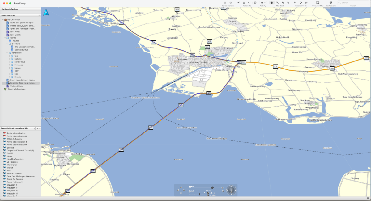

The satellite reception thing has to be a load of tosh! On the way back I went through westerscheldetunnel in Netherlands, its 6.6km long and the track log shows me entering, travelling through it and leaving. The XT may assume that as I entered the tunnel I have to come out the other end, which I did and it would then pick up reception again and continue the track log. The screen shot below shows the track log, no gaps, and I know it wasn't shouting at me to do a U turn.

Its very unlikely to be reception issues, we have both witnessed this behaviour when off route but, not every time. I admire your persistence and you must have the patience of a saint
