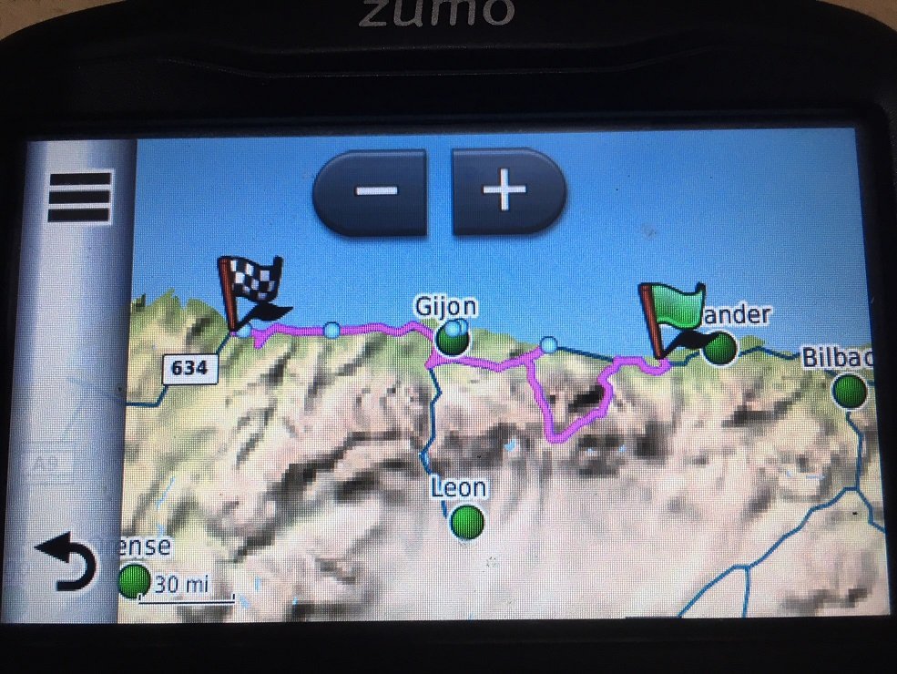

(I'm really not sure where to post this as I am new on the forum, I'm not sure if my problem lies with route planning software or my Zumo 390 unit. I'l stick it here and the moderators will no doubt move it to suit)
It may help if I try to describe what I am trying to achieve first:
I’m off for my two weeks around Europe again next month, this time for my first proper look at Spain and into Portugal. I have fleshed out the route on Google maps working with about +/- 200 miles per day and booked the hotels for my overnight stops. I want the Zumo to hold 15 “trips” that I can call up each morning and follow to my next hotel via some pre-selected attractions (or roads) with confidence.
Unfortunately the Zumo has never yet given me confidence and at the moment it is not looking like it is going to be any better this year.

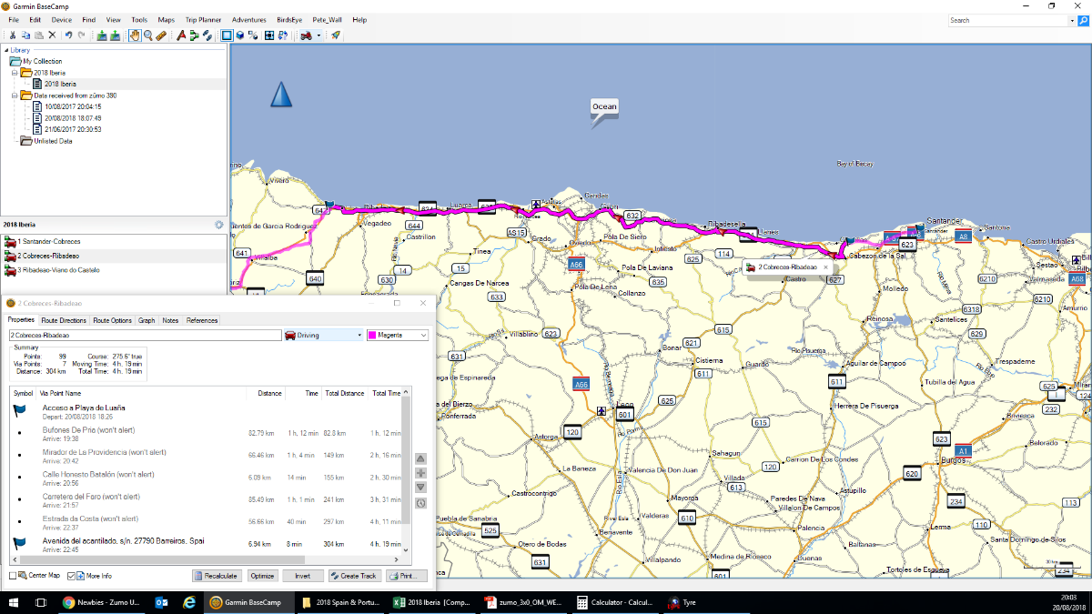

My current methodology is to plan the route using Tyre as I find the maps and search functions far better than Base Camp (I rarely get any success with an address search in Base Camp, I can’t understand why it comes up with suggestions for North America when it must know that the maps in the unit it is linked to are for Europe. More often than not the system just “hangs” and I end up shutting it down).
Once the map is drawn up in Tyre I export it to the Zumo. From there, I import it into Base Camp for checking and tidying. Then it is exported back to the Zumo (after deleting the Tyre file in there).
On the above process Day 1 is not looking too bad, but there again it is only 25 miles between the ferry port and my first hotel – not much to go wrong. Day 2 however is totally confusing. Tyre reckons my trip to be 185 miles. Base Camp calculates it at 188 miles which is near enough the same but the Zumo unit its self comes up with 327 miles. It seems to have decided that what I really need is a large unnecessary loop down into the Picos de Europa. Now, I really like the Picos and I do want to go there again one day, but I have not got time this year. Even the loop on the map cannot possibly account for nearly doubling the mileage.
Can anyone suggest what is going on? The way points on the unit are the same as in Tyre and Base Camp. I can’t see that any of my avoidance settings could be causing the issue and the calculation is based on Car / Fastest Time – I have been badly mislead by the Motorcycle / Curvy Roads option too many times in the past to consider that.
At a glance it looks like the next two days routes I have sent to the unit are also coming up with excessive mileages.
OK, it is most likely to be Operator Incompetence so can anyone suggest what I am doing wrong?

- Zumo screenshot.jpg (175.98 KiB) Viewed 8624 times
- Basecamp screenshot.png (464.99 KiB) Viewed 8624 times

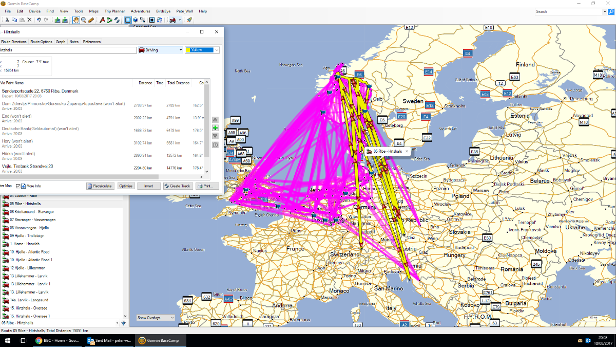

Mind you, if you think the above is bad, look at what happened last year when I tried to calculate a route between Ribe and Hirtshals in Denmark with 6 way points. This should have come up at about 325km plus a few extra for minor detours to stop offs. As you can see it managed to find me a route that was nearer 16,000km. It looks like it is picking up several places from previous trips including Croatia, Swizerland and the Czech Republic even though they are not listed in the table in Base Camp.
Pete.

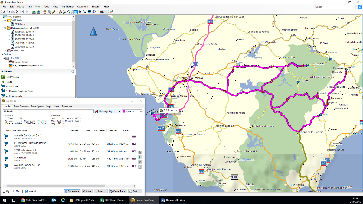

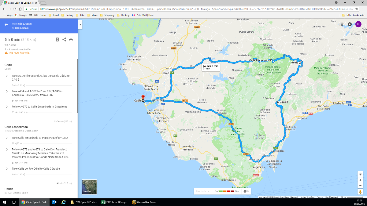

I've now had a crack at day 10; both the Zumo and Basecamp have "2019" maps and I have gone nowhere near Tyre, this is with the waypoints directly created in Basecamp.
Looking at the Google screenshot you can see my intention to make a nice round-trip from Cadiz (348km)
Putting the same waypoints into Basecamp results in a load of doubling back and a total trip of 449km
It seems to want to avoid the obvious route between the Mirador Puerto del Boyar and the Ronda viewpoint. I have added in one intermediate waypoint on the route between the two, but it just made the dead-end even longer so I have taken it out again on the image below.
Does some kind soul have a few minutes over the weekend to put the same waypoints in their systems to see if they get the same result?
Thanks,
Pete.

- Ronda Basecamp.png (455.57 KiB) Viewed 8426 times
- Ronda Google.png (546.83 KiB) Viewed 8426 times
