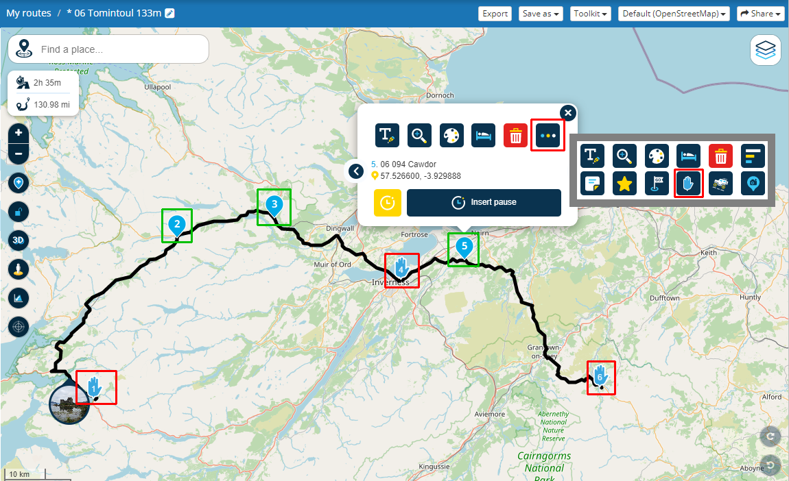

Hi @Omobono
You do not have to go into BAsecamp to identify route points as alert on arrival, or don't alert on arrival. MyRouteApp will do that as well.
They have hidden the facility away on the extended menu. By default the points are the tear drop icons - these are non-alerting route points. Garmin calls these Shaping Points. If you get the expanded menu, there is a hand raised in a 'STOP' gesture. This indicates that these are stopping points - the ones that in the Garmins will alert on arrival. Garmin calls them Via Points.
MRA has also started to use the term Via Points and Shaping Points - at least when you hover the mouse over the appropriate icon inthe toolbox.
Here is the MRA screen - with some modifications from me. Note that I have the OSM maps selected. For full comaptibility with Garmin's maps, HERE maps should be used.
MRA Symbols.png (596.52 KiB) Viewed 1794 times
Here's one of my routes in MRA. Points 1, 4, and 6 are all hands = Via Points = Alert on Arrival.
Points 2, 3 and 5 are all tear drops = Shaping Points = Do not alert on arrival.
Click the image for a much larger version.
By default when you clcik on a route point, you see the menu surrounded by a white box with 6 icons in it. The three dot icon opens up an extended menu which replaces the one in the white box. I have Paintshopped the extended menu onto the image and surrounded it with a grey box. There is now a hand icon which you can click to make the tear drop shaping point into a hand Via Point. If you click on a hand point in your route, the icon changes to a tear drop. So you can use MRA to easily switch between Via and Shaping points.
There are a couple of other issues which may concern you.
