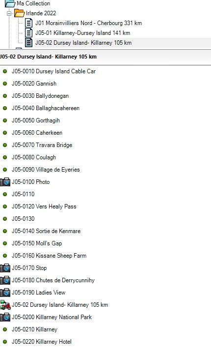

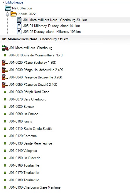

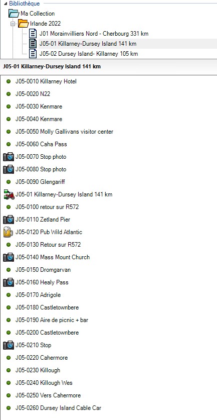

I'm taking a group of friends (11 people and 6 bikes) for a road trip in Ireland in June 2022.
To realize my itineraries, I adopt a numbering for each road book like this.
For the 1st day, each point of passage on the map will be noted Jxx-zzzz
- xx will be the day number of the road trip
- zzzz will be a numbering starting from 0010 (starting point) to the arrival point going from 10 to 10
this gives for a one day road book with less than 29 waypoints
Example of a one day road book :
In case there are more than 29 waypoints, and to avoid that the GPS cuts the road book in 2 or 3 segments, I divide the road book of the day in x road book.
I always make sure that the change of road book corresponds either to a fuel stop or to a lunch stop.
Example of road book divided in 2 :

communicator wrote: Mon May 09, 2022 11:26 am
From your image above, which I can see has been taken from Basecamp, I can see that you have 29 Waypoints created.
But your limit of 29 Waypoints is not correct. I believe that the limit is 29 Via points, rather than 29 Waypoints. It is true that when you first add a Waypoint to a route in Basecamp, it is added as a Via Point (ie alerts on arrival).
However, any Waypoint can be made into a Shaping Point. Any Shaping point can be made into a Via Point.
But a Waypoint is a point that has been created and saved before the route is created. An 'ordinary' route point cannot be made into a Waypoint'
It may or may not be included in a route.
The confusion comes because many mapping programs use the term Waypoint to refer to any point on the route. Garmin defines it differently.
Via Points have some advantages over shaping points.
They alert on arrival.
They display in the list of destinations that are displayed when you first select Go
They can display time / distance / duration to arrival in the Trip Datat display that can be added tot he right hand side of a landscaper screen.
But Shaping points are more flexible, in that if you miss one out but continue along the route after that shaping point, the XT will not take you back to it.
So your issue of splitting the route into two can also be solved by selecting some of your Via Points and changing them to Shaping Points.
The limit is 29 Via Points per route. (XT may allow 30 for a route that doesn't have to be split).
You can have 125 shaping points in between each pair of Via Points.
For the XT I use Waypoints for most of my route points now. The reason is that the XT will never change the name that I have allocated to a Waypoint. It (seemingly) randomly changes the name of other route points.
I change all of them to Shaping points. Then I choose s few (3-5) that I want to be stopping places and switch those back to Via Points.
(Start and End are always Via Points).
