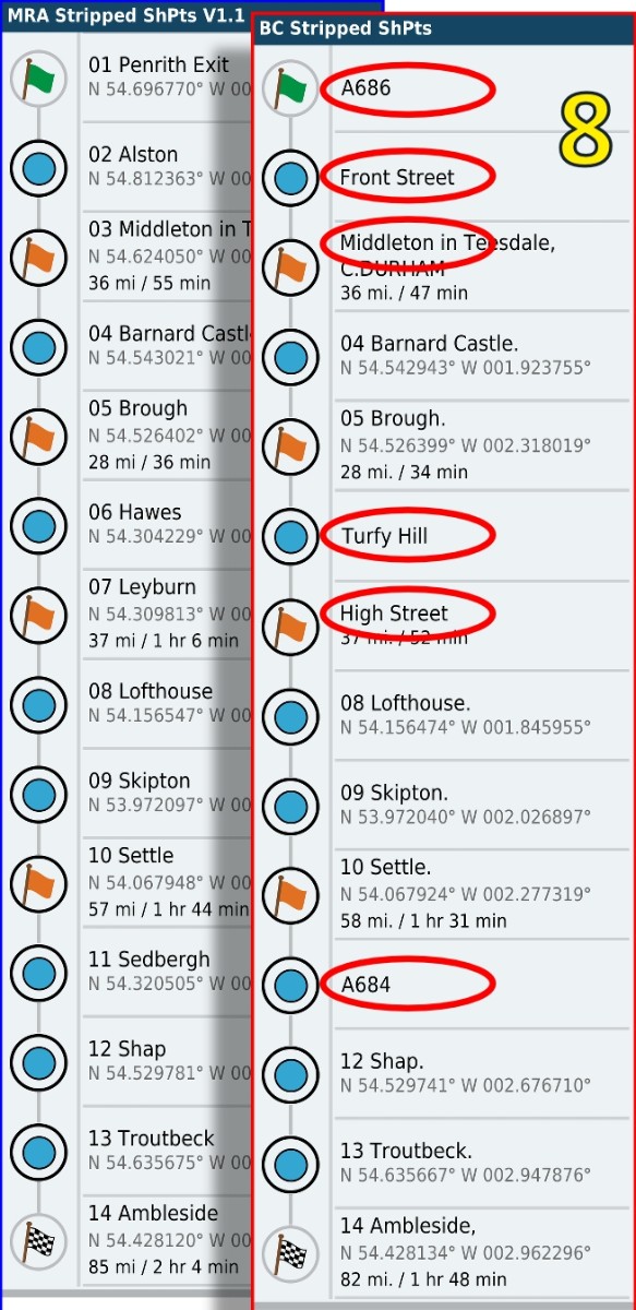

Pic 8 shows two versions of the Trip list that I have been using in the last few pages. The left hand side has come from MRA. The one hovering above to the right has come from Basecamp.
The same route points were used in both cases - I exported the GPX file from Basecamp to MRA - without any route information. All of the route points started with a two digit number. All had a short name of the town.
The Basecamp version has been modified by the XT. A number of the names have been changed - I've drawn a red oval around them - and you can see from the latitude, it has altered many of the locations. Not all of them have had their name changed, but points 01, 02, 03, 06, 07 & 11 have. 01 Penrith Exit - means something to me. 'A686' could be anywhere on a 36 mile strip of tarmac. And I have been through Hawes more times than I can remember. I didn't ever notice the road was called Turfy Hill. It is meaningless to me. I wanted it to be called Hawes. That's why I named it like that.
It isn't MRA that has developed a unique solution to this problem - it just brought it to my attention. It seems to have come about by not having the gpxx:Subclass tags that I highlighted in the previous section. Using Basecamp, if you edit all of those commands out (tedious, and you wouldn't do this unless like me, you were trying to find out what happens) or if you change the profile to be a customised Direct Route - the subclass string get replaced with a load of 0's and F's. And they don't get renamed either. The lat/long still gets modified slightly, however. But the XT calculates the route from the route points, and the names do not get altered. Not yet anyway.
(Incidentally, neither do they get altered if you create the points as Waypoints first)

A new feature was introduced with the XT. When a route is imported, it tends to change the name of the route points that you have used. So if like me you use a sequence number or add the mileage to the front of the name, then this information gets lost. "087 Sam's Cafe" means a lot more to me that "Innominate Lane".
It doesn't do it if you create the point as a Waypoint first - which is what I had started to do in Basecamp.
In those gpxx extension definitions, after each route point is a special hexadecimal string of characters. I have been unable to find out what these characters represent, although I suspect that is has something to do with the characteristics of the next section of road speed limit, road surface, vehicles suitability - that sort of stuff.
It looks like this '(- gpxx:Subclass -) 03003676CC01AFE609002116000057001400 (- /gpxx:Subclass -)'
I have had to change the greater and less than symbols to brackets - they get stripped on when shown on this site.
Anyway MRA misses this out and lets the Zumo fill it in. And guess what - MRA routes do not get the names of route points changed. I tested it on a Basecamp route. Leave these lines in, the names get changed. Take them out of the same route (or substitute a default), and the names do not get changed.
