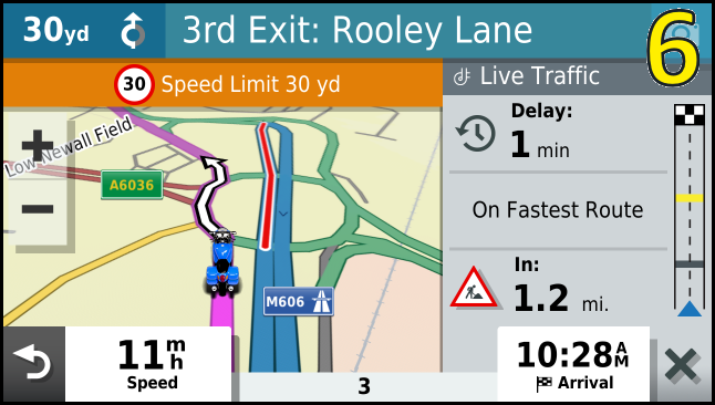

Pic 6 - On the right hand side of the screen you are able to select from a number of panels that provide you with information or with easy access to controls. The bottom right hand corner will show one of two buttons: A cross 'X' which is the symbol for closing down the display; the 3 dot menu - the 3 dots are arranged vertically, but the message is that there is more stuff to come ... So Towns Ahead, Up Ahead (which is configurable), Trip Data, Weather, Traffic, ... are all available panels, along with some controls such as Music Player and Track Recorder.
Traffic is what has been selected to display the right hand panel in picture 6.
However - the Traffic Panel may pop up by itself - if you are following a route and the XT spots road closures or delays up ahead, it will show itself, even if you have a different panel open. AFter a little time it will then disappear again. Or you can cactivate it yourself - in which case it stays there until you replace it with something else. Occasionally it will offer a detour. In practice I find that the delays are a little slow in being removed when the traffic has subsided - so you have to ask yourself the question - do you feel lucky ? If it was likely that there was a delay an hour ago - because was rush hour - I'd just ignore it.
Tapping the display pops up a more detailed map showing closures and delays.
