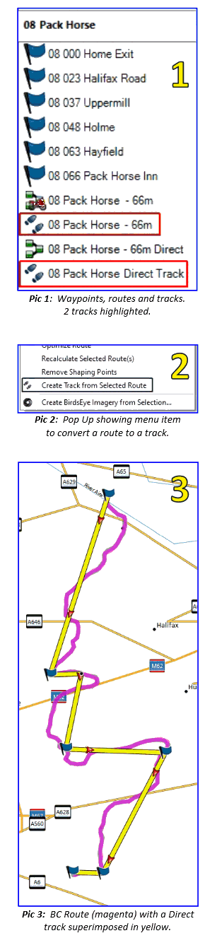

Pic 1 shows the contents of a List, taken from Basecamp. It shows the components of a route that I intend to follow on Day 8 of my Trip.
There are 6 Waypoints (the blue flag icons). I have added the day number and mileage to each named Waypoint.
‘08 Pack Horse - 66m’ is the route with the motorcycle profile icon displayed.
Underneath is the track that I have created from the route. This is easy to do in Basecamp - right click the route and select 'Create Track from Route' from the popup menu.
At this point, the track and the route are identical, so it is impossible for me to show one superimposed on top of the other ! So instead, I created a straight line (Direct) track which uses the same route points defined in the Trip.
Pic 3 shows this combination of route and track on the Basecamp screen. Remember that at this stage the route and the track would be exactly the same shape, - with one of them completely hiding the other.
The idea is that when these two are both set to display on the XT’s screen, if the original magenta route changes, it will be obvious as the yellow track underneath will become visible.

Note regarding Picture 3
Normally the route and the track would follow the same course, but that is impossible to show as one would hide the other. Instead I have drawn a Direct route in yellow on top of the magenta track, so that both can be seen.
