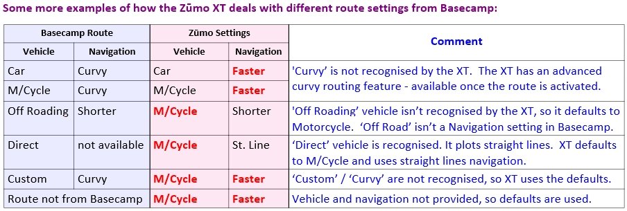

The Zumo XT will recognise three of the Basecamp’s Activity Profiles. These are Driving, Motorcycling and Direct. That is all. If you transfer a route with any other Activity Profile, the Zumo will default to Motorcycle. Curiously, it does not recognise the Basecamp ‘Off Roading’ profile, or any of the others.
The XT will recognise only two of Basecamp’s Route Preferences: Faster
Time or Shorter Distance.
Although Basecamp has Curvy Roads as an option for Motorcycle, the XT does
not recognise this.
If the Zumo receives a route with an unrecognised Routing Preference, the
Zumo will default to using Faster Time.
If you send a route from other route creation software without a vehicle name or navigation type, the Zumo will resort to using its default Motorcycle / Faster Time combination.
This is quite an alarming revelation. The following are some examples of how the Zumo deals with various route settings from Basecamp or other sources.

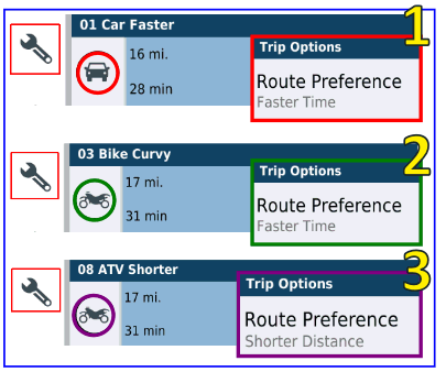

On Loading a Trip
When a route is loaded into the XT with the Trip Planner App, it reveals what settings it will use. The vehicle icon shows what vehicle the Zumo has decided to use. The spanner reveals the Route Preferences that it will use. These two settings over-rule what is set for the Zumo when a route is not loaded.
In the three examples below the route name shows what modes I used to
create the route in Basecamp.
The settings that the Zumo uses for these routes is shown outlined in red
boxes or circle.
Before conducting each test, The Vehicle was set to Off Road and Calculation Mode was set to St. Line so that any changes were obvious.
Ex 1 The BaseCamp Trip was set to Car & Faster Time
The 'Car' icon is displayed and Trip Options show Faster Time.
Ex 2 The BaseCamp Trip was set to Motorcycle and Curvy.
The route shows Motorcycle and Trip Options show Faster Time. (not Curvy)
Ex 3 The BaseCamp Trip was set to ATV & Shorter Distance.
The route shows Motorcycle and Shorter Distance. ATV is not recognised by the XT
More examples of different route settings:
