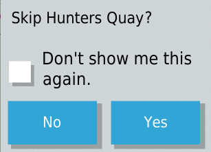

If you do not want to visit a Via Point, then just like the Shaping Point, you can ignore it. The XT will continue to navigate you towards it, but the second time that you ignore its instruction, it will display a familiar message on the screen: ->
If you say Yes - the Via Point is skipped. If you ignore it, or can't press 'Yes' before it disappears off the screen, it will try another 2 attempts to redirect you. Ignore those and the same thing happens again.
If you choose 'No', you do not get another shot at this - it will continue to nag you forever, and the only way to stop this is to manually skip the point, as described in method 1) or 2).
Instructions to perform a U-Turn do not seem to count towards the tally of 2 before the message box appears again.
If you tap "Don't show me this again", you can turn it on again Settings -> Map & Vehicle -> Skip Next Stop Confirmation.
