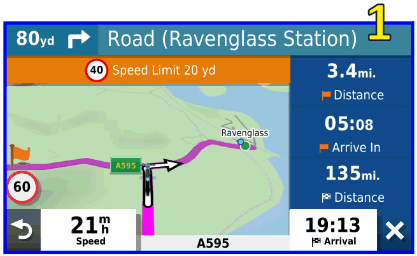

You don’t have to follow the instructions - but it helps if you know what will happen if you don’t. For example - the route in Pic 1 is telling you to turn right in 80 yards. You can see that it goes to Ravenglass - there is a blue disc shaping point there, and then it will turn round and head to the orange flag Via Point - placed to the left of the junction ahead. Ravenglass is intended as an optional stopping place. The route navigates me to Ravenglass, but the fact that it is a shaping point means it is an easy point to ignore.
If you ignore the instructions the satnav will try to find another way to the same point. If you keep ignoring the instructions, it will ask whether you want to skip the next point. This is described on the next page.
In the example above, if you choose to turn left towards the flag, instead of right towards the shaping point, the satnav doesn’t complain and it will continue to navigate towards the flag.
Why does it do this, if it is supposed to take you to a shaping point ?

Knowing that it is easy to miss out a shaping point makes it possible to put in an ‘optional’ stop. Put a shaping point at the potential stop, and put a (say) Via point on the route after the stop. (As in Pic 1). This ensures you are on the correct route whether you choose to visit the stop or not.
