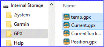

When the Zumo is connected to a computer by a USB cable, it gives access to the folder structure - part of which is shown in the screen shot below.
In Internal Storage / GPX there are a number of files. Two of these are relevant to the transferred and imported routes.
temp.gpx This file stores recently transferred data from Basecamp. Current.gpx
Current.gpx is used to store the list of routes that have been transferred and imported into the Zumo. ie it stores the current list of saved routes.
Trips can be deleted from the list of Saved Trips from the Zumo’s screen. Any routes that are still present in temp.gpx can be re-imported. Very handy - but do not get caught out by the ‘Garmin XT USB Gotcha’.
Either of the above files can be deleted, but Current.gpx will rebuild itself when the XT is powered up from cold.
