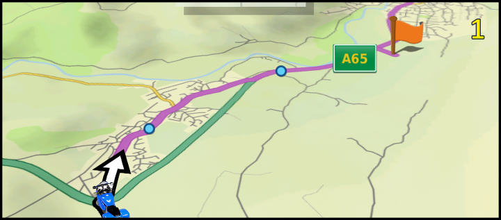

Pic 1 - A Typical Route - DemoThe bike is located at a roundabout. The plotted route takes the second exit as indicate by the magenta line and the white arrow. The route passes through a shaping point at a cafe in the small village.
I decide not to visit the cafe, so I take the 3rd exit which is a 3-lane by-pass - the green road - A65 - on the screen shot. The second shaping point is located after the point where the village road and the by-pass meet.
U-turns are permitted for these illustrations - but the by-pass is a fast 3-lane road. The XT knows this and it will not request a U-turn here.
A Via Point at the top right is badly positioned in the middle of a field. This will be part of a later test.

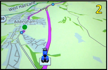

Pic 2 - 'Saved' Route - Missed Shaping Point
A detailed description of all of these behaviours is given at the bottom of the page.

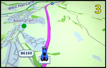

Direct link to the Video Page for the example in Pic 3 is here

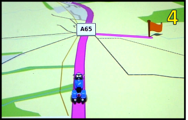

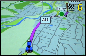

- Within 5 seconds of ignoring the route to the Via Point, the screen changed to that in Pic 6.
- No Info. No Request to Skip.
- The route ahead is now a bright magenta - so it is the current section.
- The magenta line behind me has disappeared (compare Pics 2 and 3). It is as if the XT has calculated a new route from my current position through the remaining route points.
- The Via Point flag has been removed from the route
Direct link to the Video Page for the example in Pic 6 is here
