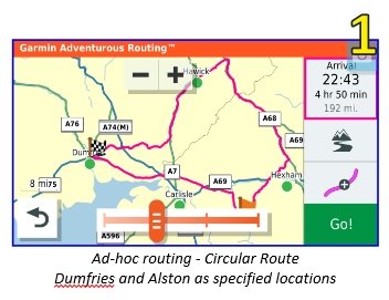

Ad Hoc Navigation
Set the vehicle, Select Faster Time or Shorter Distance, Set any features that you want to avoid and the satnav will plot a route to get you there. The XT has a few additional features - Curvy Roads, Round Trip (given a couple of points or a time or distance).
The Zumo will produce a route over which you have limited control, but it will give turn by turn directions and get you to where you want to go - or take you on an adventure! No planning is required, just follow it. Easy.
Curvy Roads can also be applied to an existing Trip. The route will visit each route point but will apply the selected level of adventurous routing beween the route points.

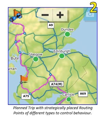

Plan a Long Trip
Create a few ‘must visit’ points and use them to form the basis of your Trip. Let the software choose the roads and then add a few more intermediate points to pin the route to the roads that you prefer.
The XT will follow the route, giving turn by turn directions. In some circumstances it may recalculate the route, but it will always go through all of the points that you specify.
Planning a Trip is a compromise between minimising the number of additional points and ensuring that the satnav goes along your preferred roads.
Getting to know how the different route points behave and how and when the XT is likely to recalculate the route, is the key to getting a trouble free Trip.

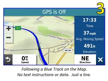

View Tracks on the Map
Tracks are simply lines drawn on the map - or a record of where someone has ridden before. You can display the track on the map, and the satnav will keep the map so that your position is always on the screen.
The XT can not navigate the track in this mode (but see below). There are no instructions - spoken or on the display. The XT shows your position and a coloured line, nothing more. The track will never alter - if you wander away from the track, the map will show the track going one way, and your position will be somewhere else. It is up to you to read the map to stay on track.
This is the smart version of having a paper map and marking your route with a hi-lighter pen. It is a very useful tool to have - ultra reliable - it cannot think for itself or lead you down somebody's garden path. It is just as effective for off road use as well as on roads.

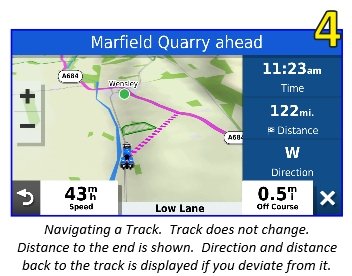

Navigate a Track.
The XT comes with the ability to ‘navigate’ a track. It still will not give directions, and in fact behaves in exactly the same way as the track in the paragraph above. But this time if you wander away from the track, it tells you how far away the nearest part of the track is - and it draws a dotted straight line in the direction you would need to go. See the screen shot (Pic 4). It’s up to you to find the roads to get you there.
This is probably designed for off road use, but it works quite well for on-road use as well. Having set off to test this thinking that it would be a waste of time, I was surprised how useful this could be.
