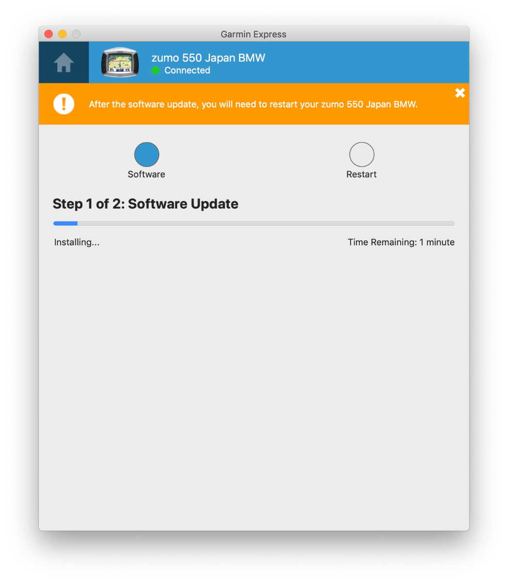

This is my update process:
Step 1
Step 1
Screenshot 2020-06-23 at 21.34.15.png (585.19 KiB) Viewed 4512 times
Step 2
Step 2
Screenshot 2020-06-23 at 21.34.40.png (301.35 KiB) Viewed 4512 times
Step 3
Step 3
Screenshot 2020-06-23 at 21.35.26.png (352.18 KiB) Viewed 4512 times
I've completely followed the instructions from the last step. The device was disconnected and connected again after 5 seconds. I didn't see any update process after that, just regular plugging process to my laptop. After that I could open mass storage and see the GUPDATE.GCD in the Garmin folder. Garmin Express still showed me the last step (last screenshoot). I've tried to wait some time, tried to reboot, but it didn't help. I still see ver 3.15 in preferences.
Btw the bluetooth firmware and smth else (I forgot what exactly) was updated successfully.
I hope that I am doing something wrong and it is not a problem on the part of Navi or express :)
