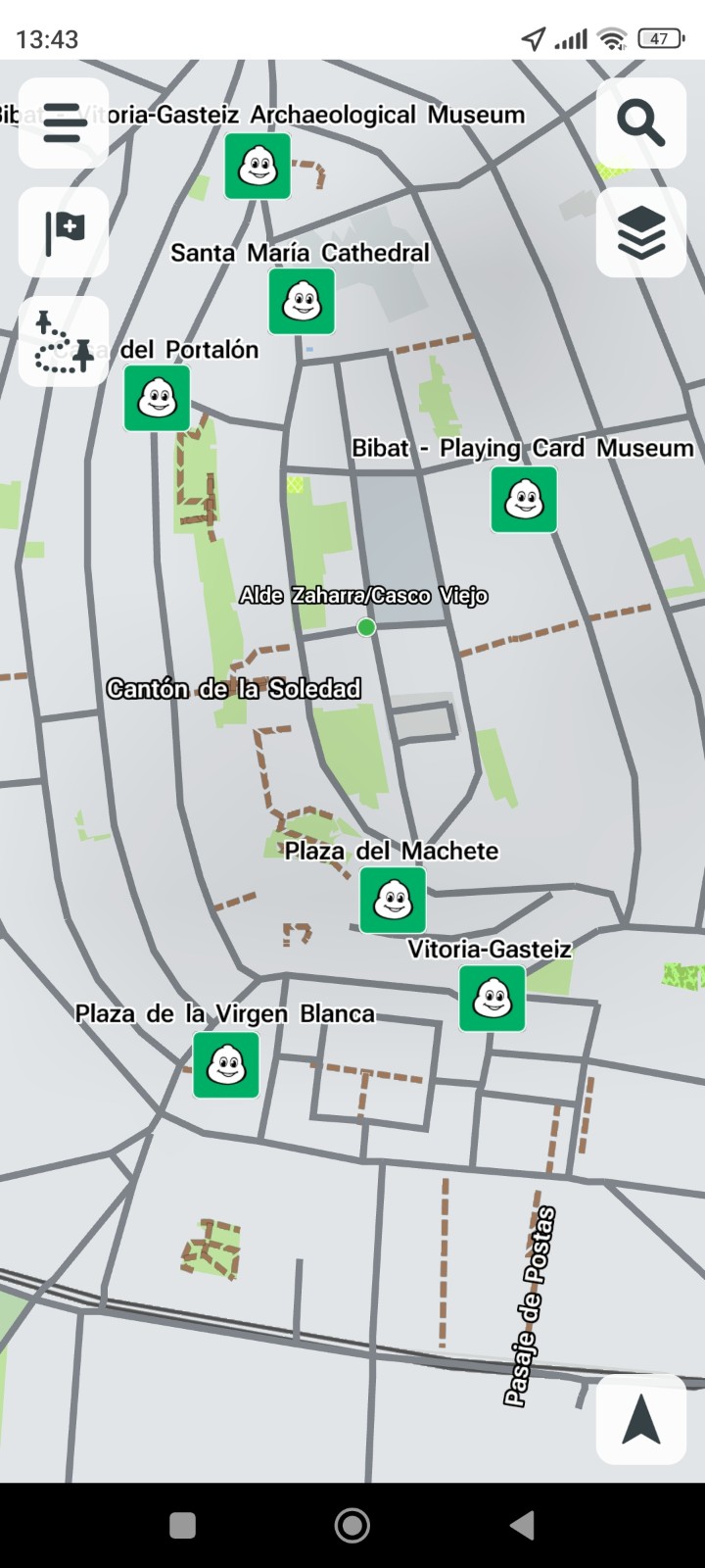

Totally agree. In this version (Version: 2.08.37) I have found the following bugs (I understand that they do not have any beta tester at Garmin):
- Michelin icons (POIs) have disappeared from the Tread App map. You only see the scenic roads in green now.

Update of Tread App Map. Looks like the Michelin Pois were gone because of a map update.
Now are available and visible again in the map. ;)
