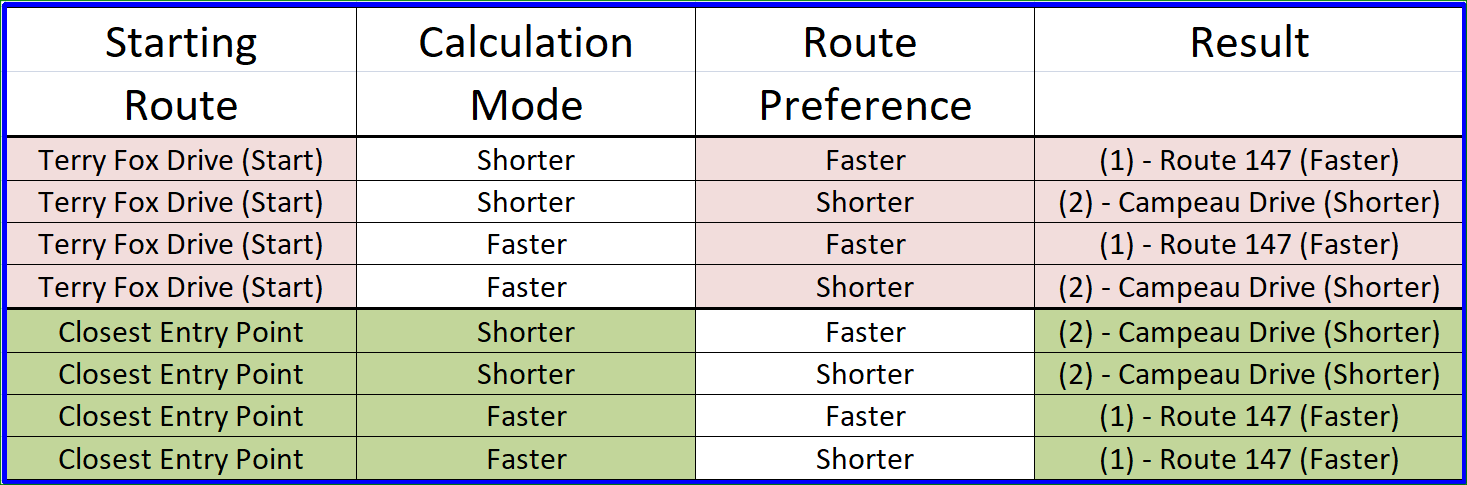

I got just two results from 8 different tests.
Route 1 - Heading right to pick up the 417.
Route 2 - Heading left along Campeu Drive

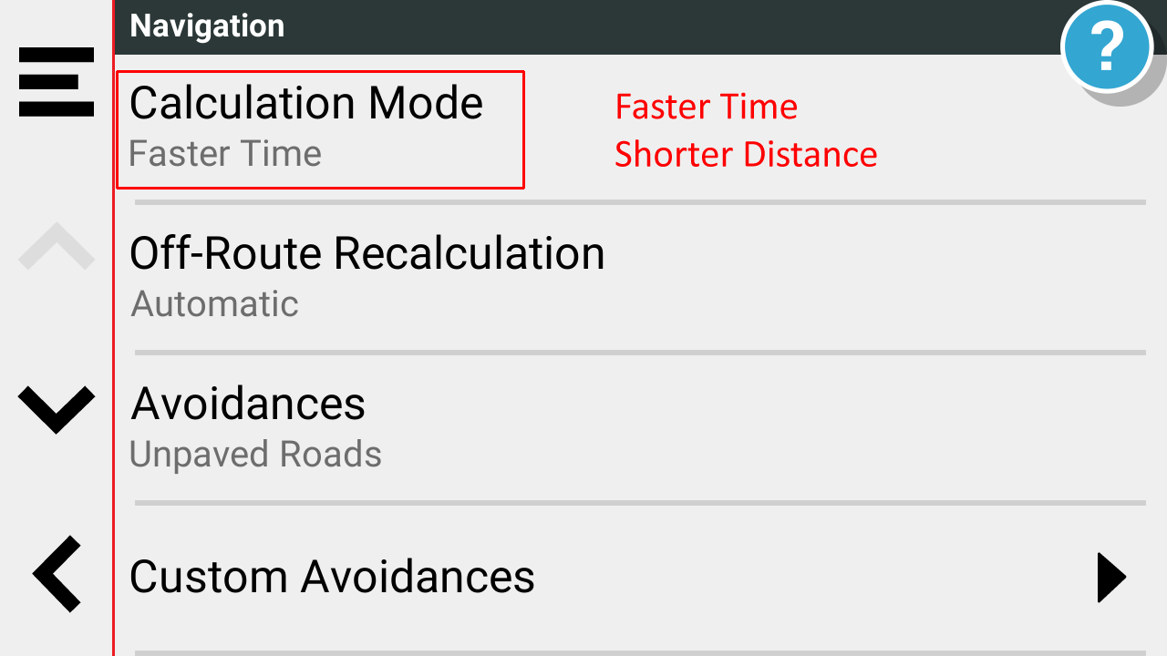

For the route I carried out all 8 combinations of selecting
Calculation Mode: Faster Time or Shorter Distance:

The Results
What happens depends on how the route is started.
If you select the start point, then the route to the start is always calculated by the routing preference that is set for the route itself.
If you select Closest Entry Point then that section of the route is controlled by the Calcualtion mode preference set in Settings->Navigation.
Whether Campeau Drive is faster way or a shorter way than to go than Route 147 isn't up to us to decide. The Zumo thinks that Route 147 is faster and Campeau Drive is Shorter. When heading for the next point, if there was a fast road nearby, the XT seemed to head for whichever was faster - getting to the actual point or getting to the fast road that would take it to the point - as if it took no time at all to reach the point once you were on a fast road. I have good indications that this may not be the case with the XT2.

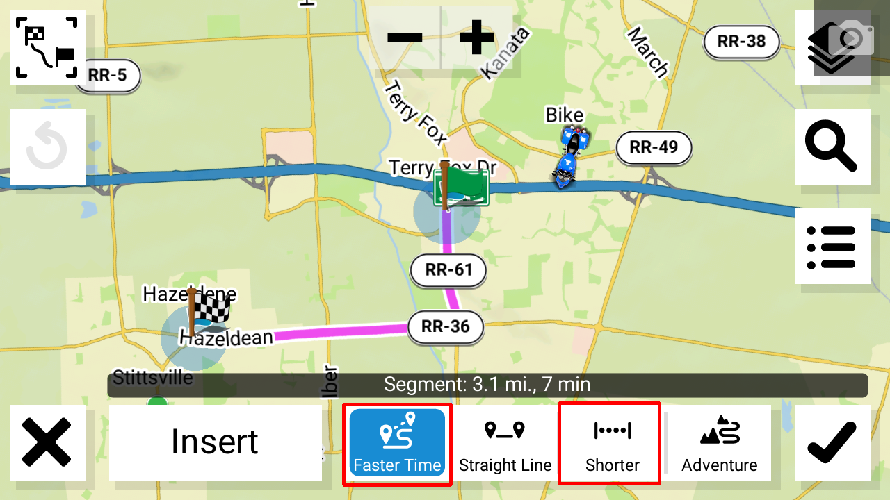

@jfheath Your route is close. It should start on the other side of 417. So, between Campeau and the 417 on Terry Fox. Mine ends sooner than yours on Hazeldean, but that's no matter. You are correct that I am sitting on Gray just off Campeau when I start the XT2 navigating.
I did as you advised. I created the route on the XT2. Two points - the start on Terry Fox just left/south of Campeau (this is north of the 417) and the end on Hazeldean just right/west of Terry Fox. I started it running on Gray near Campeau. This time, it did exactly what it should do. It had me turn left onto Campeau from Gray and follow that to Terry Fox. Then another left on Terry Fox. It announced the start point on Terry Fox, then a few metres later, told me to continue to Hazeldean, where it told me to turn right.

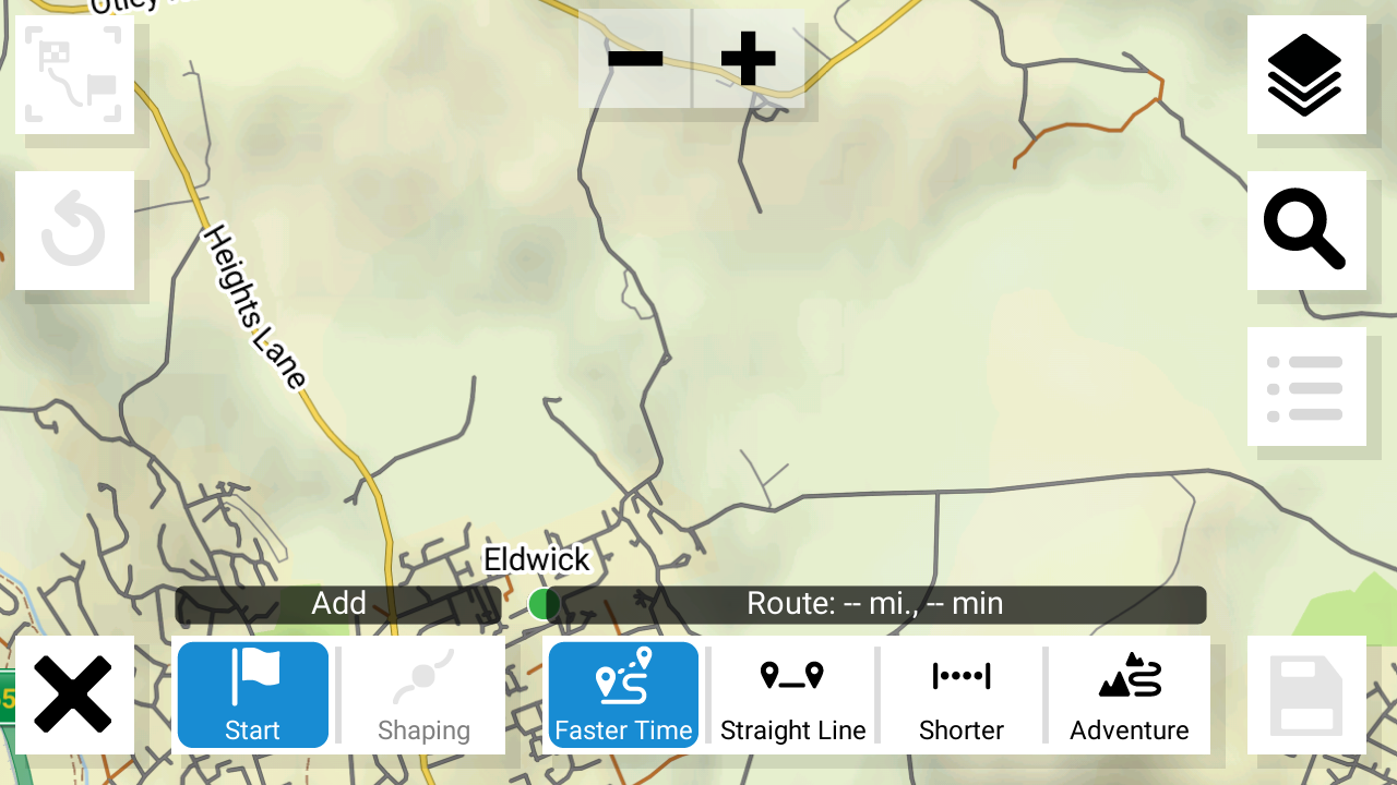

To build the route on the XT2 exactly - create your route points as Waypoints in Basecamp. Transfer those to the Zumo.
Build the route using the Waypoints. I jotted this down in a post last night or early this morning - but I was on my ipad and working from memory. I'll do it with XT2 in hand.
Assuming you have your waypoints in the XT2;
Apps Icon -> Route Planner. You get the map that looks like this
The start button should be selected, and the route pref - FAster Time.
Tap the magnifying glass
Select Waypoints
Choose your waypoint from the list - you may need to navigate collections to find it.
Select 'Select'
A Flag will appear on the map where your waypoint has been placed.
The Start button has changed to stop. Make sure it is selected. Tap the magnifying glass
Waypoints-> Choose the waypoint->Select
A straight dotted magenta line appears briefly on the screen, and it then changes to a route.
Click the black disc icon, bottom right.
Give your route a name.
Done
Select Go - or back out of it and find your route in Apps->Route

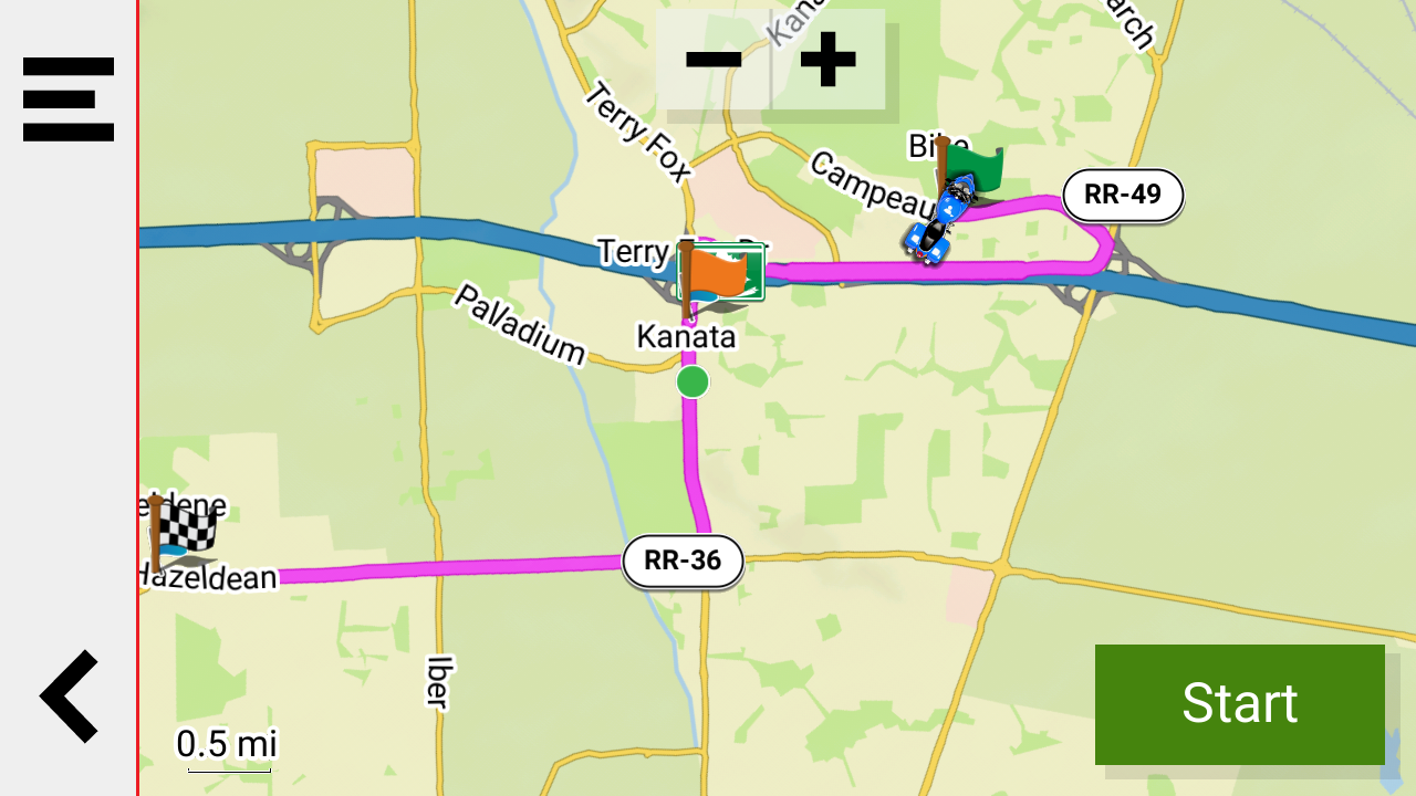

I caused the confusion JF. Sorry about that. In my posts, I started with the screencap of the longer route that did, indeed start south of the 417 on Terry Fox. When that one took me east, then west then south, it did start at the start point. I was curious to see what it would do if the start point was north of the ramp exit on Terry Fox. So, when entering Terry Fox, I would be going the wrong way to pick up the start point. I did not post screen cap of that one. I just described what I was trying to do.
That's when things went haywire. It also took me east and onto the 417 then west back to Terry Fox. But, it was that one that then turned south and ignored the start point altogether.
Both of these were using the closest point as the start point. When I then used the actual start point, it was still with the route that started north of the 417. That was the one that wanted me to make a u-turn after getting onto Terry Fox from the 417.

@jfheath Today's trial was a success. I followed the advice to set the start point closer to home. I set the start point on Campeau about 50 metres west of where I would start the navigation. I set a shaping point just after the intersection of Campeau and Terry Fox. Next shaping point was just after the next turn onto Palladium. Next just after the turn onto Silver Seven. Final was just after the turn into the Home Depot parking lot.
I start navigation on Gray just off Campeau and set the starting point as the start point on Campeau. The XT2 sent me left/west onto Campeau. (finally) It announced the start point when I reached it, then told me to continue to Terry Fox. From then on, it told me to make the turns that I would expect to make.
In short, the advice to set the start point closer to where I was sitting when I started the navigation proved to be the solution to my "wrong direction" issue.
