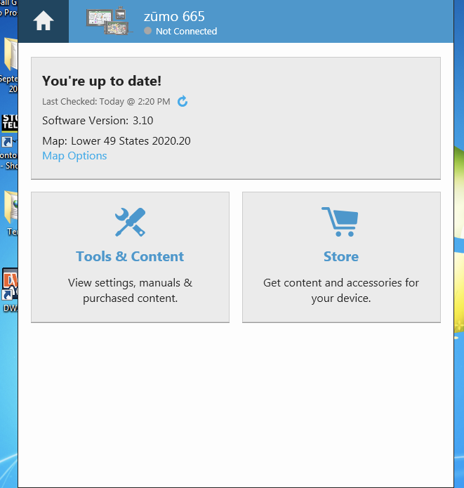

I have been riding around northern California for the past week with no access to the forum.
This is what the PC version of Garmin Express looks like:
Clicking on "Tools & Content" bring up this tabbed menu where I have clicked on "Utilities":
Scrolling to the bottom reveals the memory usage:
