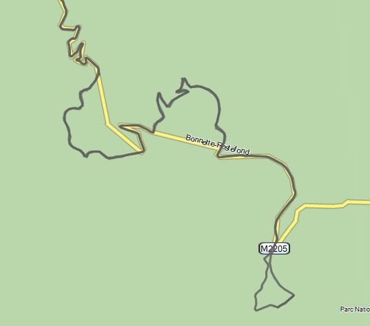

I had problems going up the Col de la Bonnette this year, which drove the 595 berserk.

this was fixed by a firmware update I believe.

I used ONLY shaping points and no, stopping the route and starting it again totally changed the route made in and transferred from BaseCamp.
Re: Zumo 595 thoughts after 1500km (1000 mile tour)
sussamb wrote: Mon Nov 05, 2018 1:12 pm Sounds more like a map issue and nothing to do with your device. Can you post which road?
I realize it was probably a left over road closure when routing in BaseCamp. The problems I had was that the 595 A) would not let me delete a shaping point and 2) would not continue with the route.
