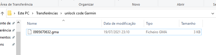

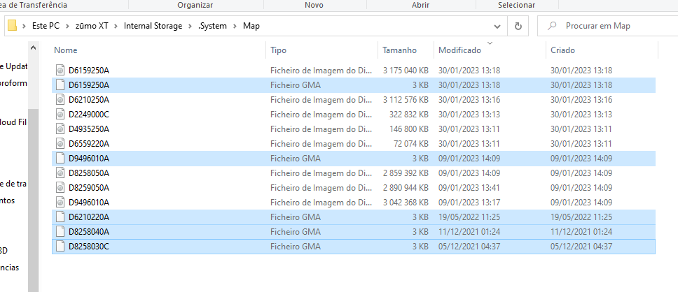

This is the .gma file I copyed from XT and then imported to PC with JaVaWa GMTK:
folder with gma file from XT
code XT.PNG (13.48 KiB) Viewed 5177 times
I notice the date says 19/07/2021 and the file doesn't starts with a letter D ????
Is it possible that the problem is within the Zumo XT that somehow the code is wrong?
Maybe some problem on the instalation and that's why it cannot transfer the map and unlock codes properly to the PC and Basecamp?

Not sure if the filename needs to start with D. But the file date is suspicious. If the map on your Xt is not correct, it would explain.

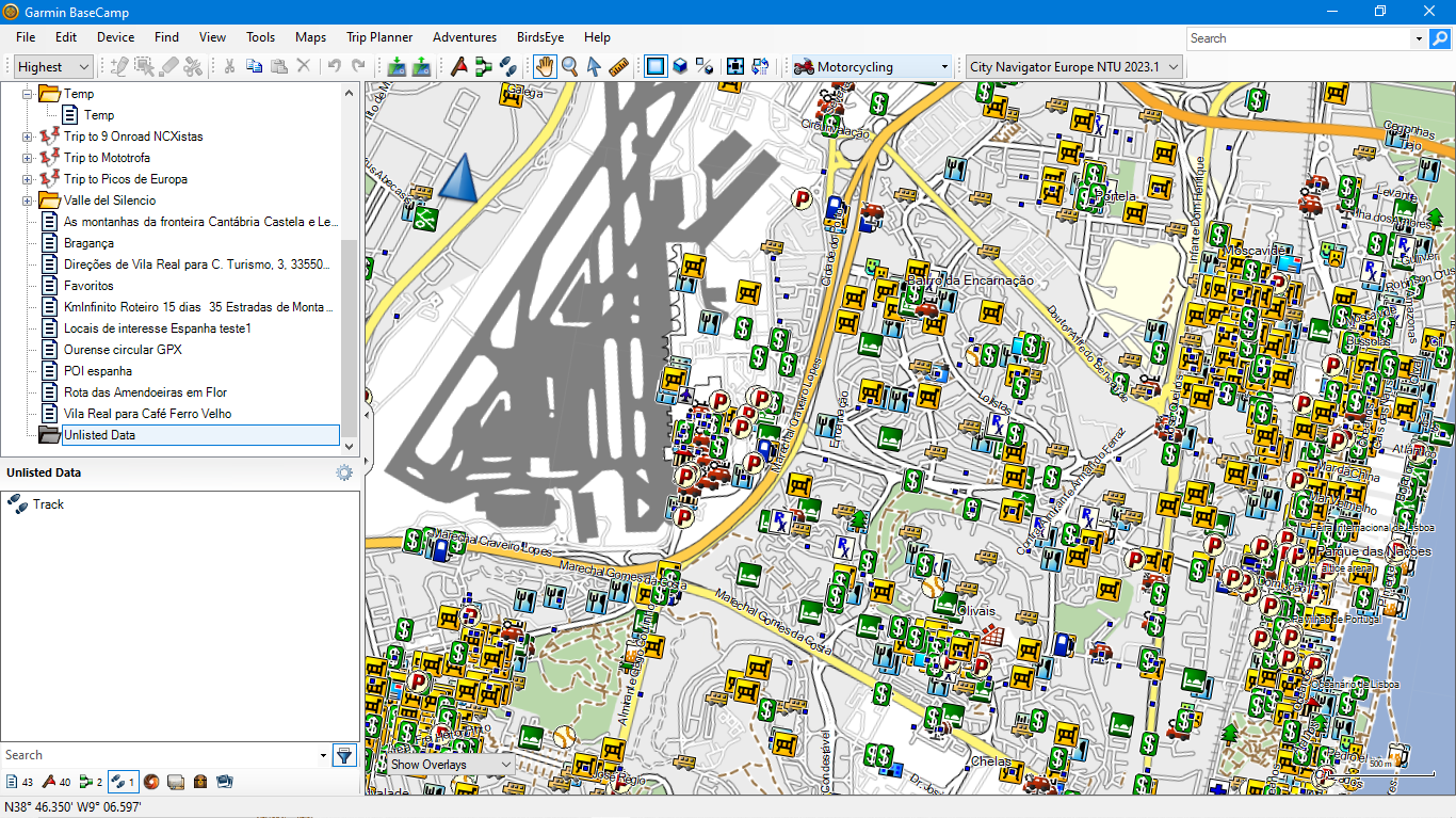

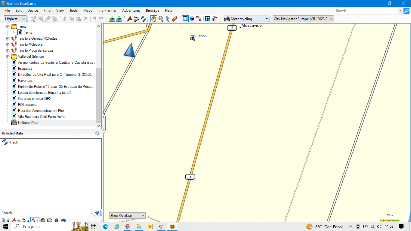

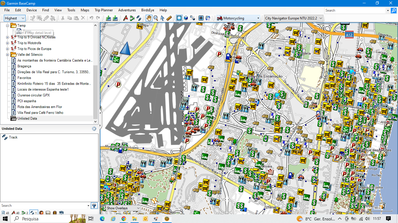

@sussamb the 2023.2 map shows Unlocked or Unauthenticated on Basecamp and has no detail. Only shows main roads like highways and a dot on cities, no streets or POI.
The maps that have full detail are 2022.2 and 2023.1 that I previous installed on PC Basecamp without any problems.
Bellow are screenshots of the same area (Lisbon airport) with the same zoom level on each map:
Europe 2022.2 at 500m zoom
Europe 2022.2
Europe 2022.2
Europe 2022.2.PNG (1.16 MiB) Viewed 5174 times
Europe 2023.1 at 500m zoom
Europe 2023.1
Europe 2023.1
Europe 2023.1.PNG (1.14 MiB) Viewed 5174 times
Europe 2023.2 at 500m zoom ("map detail locked" yellow message on bottom right corner)
Europe 2023.2
Europe 2023.2
Europe 2023.2.PNG (203.98 KiB) Viewed 5174 times

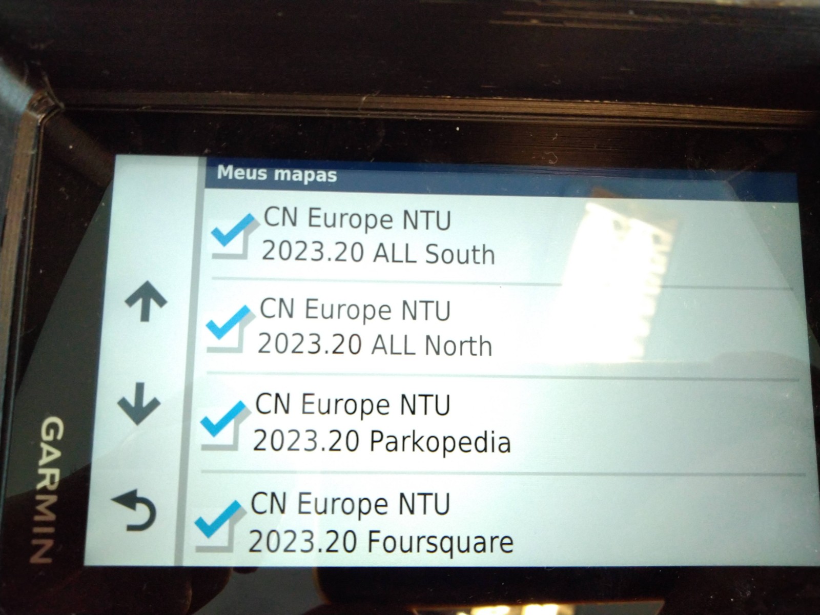

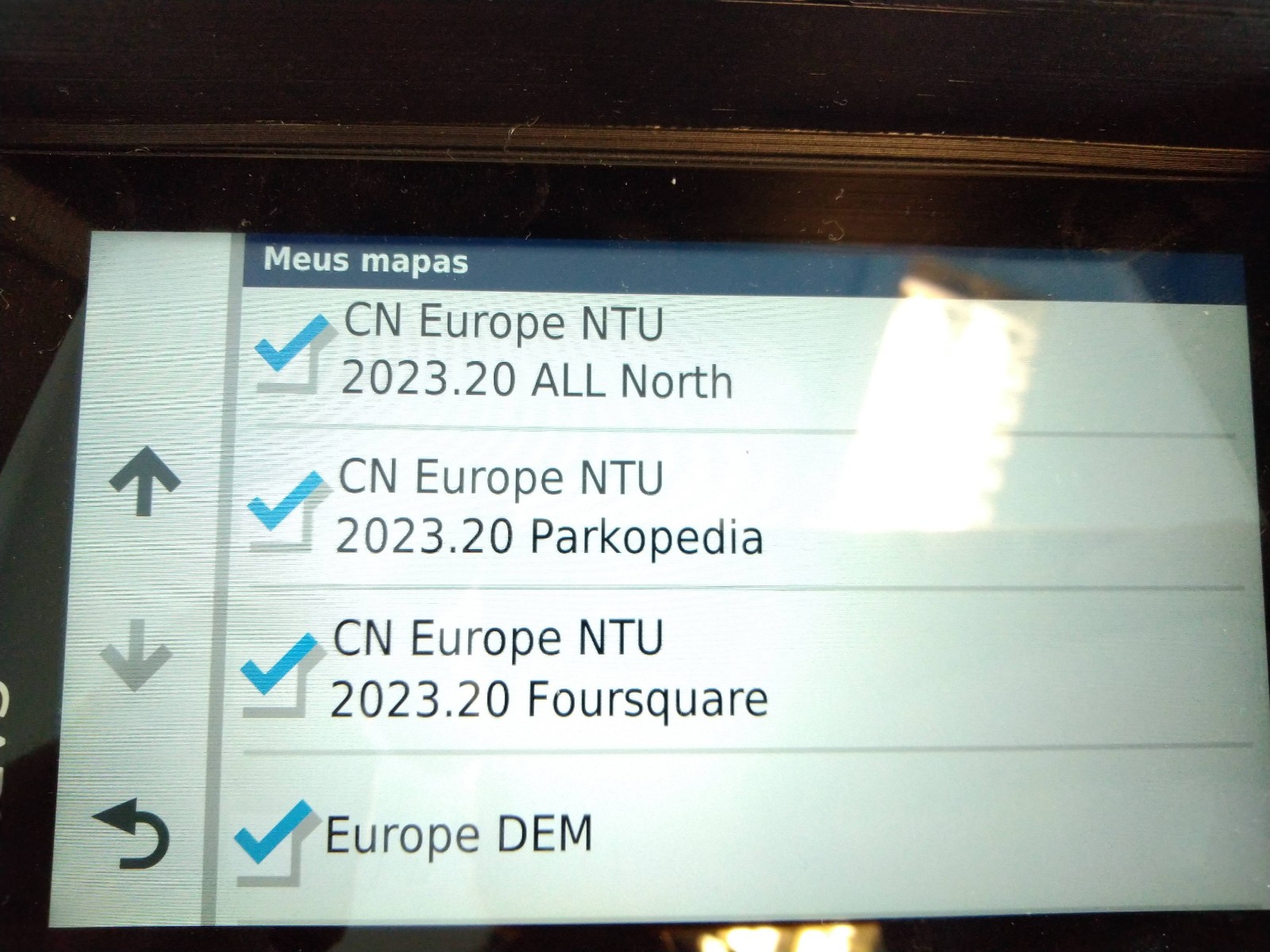

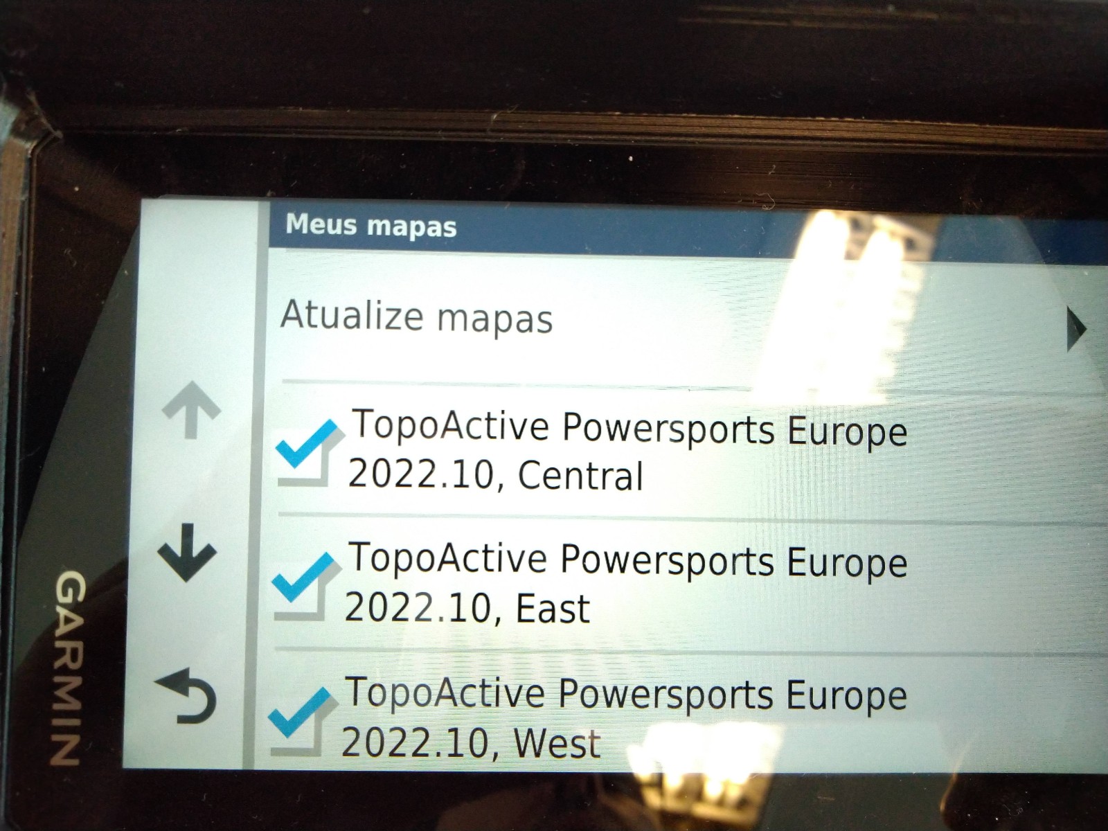

- See bellow these photos from XT My Maps:
Zumo XT My Maps 1.jpg (344.96 KiB) Viewed 5172 times
Zumo XT My Maps 2.jpg (260.16 KiB) Viewed 5172 times
Zumo XT My Maps 3.jpg (342.98 KiB) Viewed 5172 times

The maps on the Xt look good. But what I dont understand. I think you should have 2 GMA files. At least I have 2 GMA files and have the same maps as you.

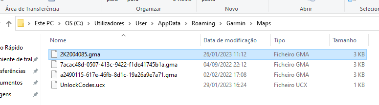

FrankB wrote: Mon Jan 30, 2023 12:47 pm The maps on the Xt look good. But what I dont understand. I think you should have 2 GMA files. At least I have 2 GMA files and have the same maps as you.
It made no difference, on your PC, after you imported the GMA File I assume?
Yes, reinstall with Garmin Express.
The .gma file highlighted in blue is the one sent by Garmin Support. It's still on the folder but the map remains locked.
But there are another two .gma files in this folder. The ones with a long name...
And an .ucx file too.

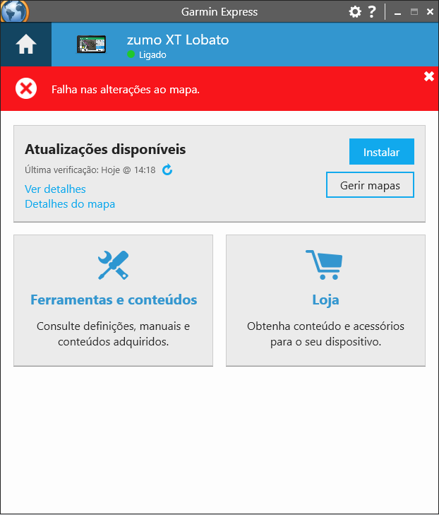

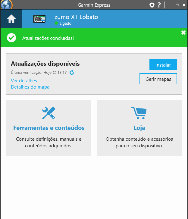

I reinstalled the map on Zumo XT. Everything went ok:
Zumo XT map reinstall.PNG (48.97 KiB) Viewed 5161 times

I then went to Zumo XT folder to check his .gma files and found all these 5 including a new one dated today:
codes XT.PNG (54.56 KiB) Viewed 5161 times
I might try to import these again to PC usisng JaVaWa GMTK. What do you think?
In that case should I copy all these 5 .gma files or only the most recent one?
