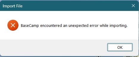

I think there is something else wrong in the gpx formatting, as Basecamp will not load the track:
2025-04-10 20_13_12-Garmin BaseCamp.jpg (12.8 KiB) Viewed 2549 times
I even edited the gpx, removing all but a hundred track points, and received the same error message.

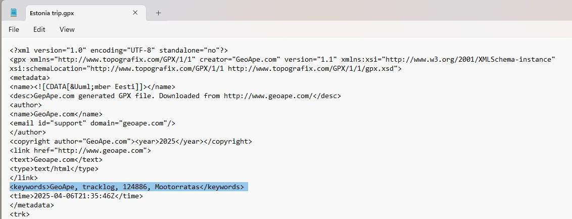

The problem is in the MetaData. If I remove the <keywords> line, it loads in BC.
