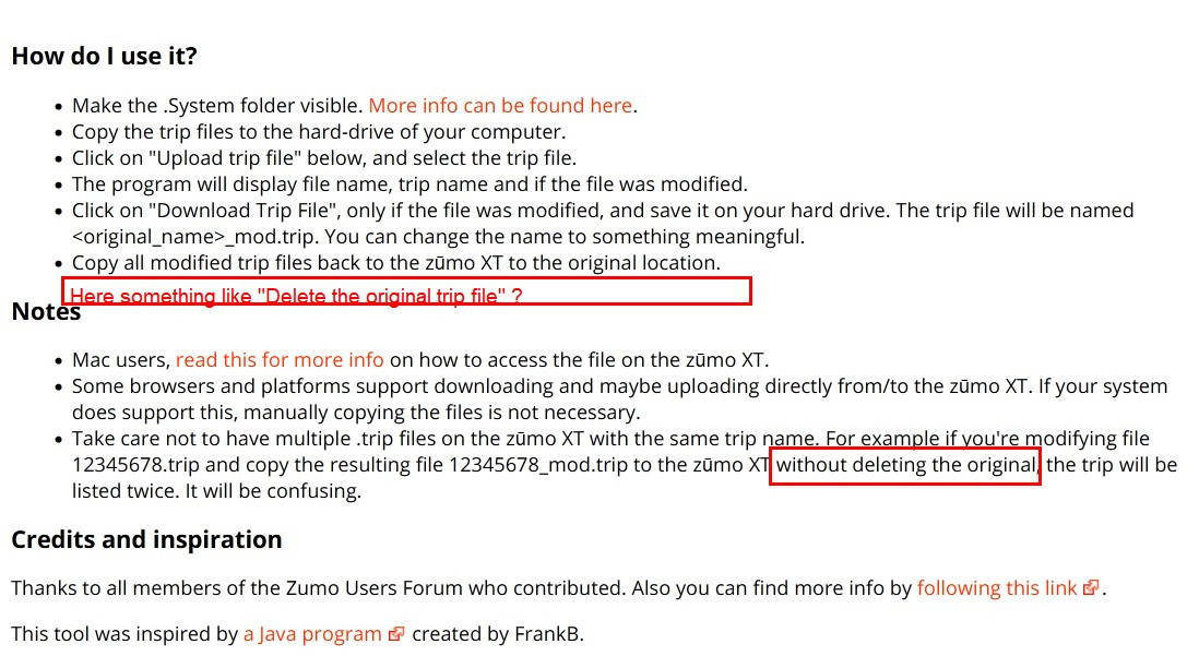

@FrankB, thank you for your work on this. It really is easy to use. If I had read more deliberately I would have picked up on this detail. You might consider just adding another bullet to the "How to I use it?" section saying to delete the original .Trip file. Also, if changing the modified .Trip file name doesn't seem to have any effect (per @Peobody) then maybe that reference could be removed for over-thinkers like me.

Now If I understand you correctly you're proposing something like this?
I think you're right, the remark is somewhat hidden, but I don't think you will make that mistake again, and you're the first to make that remark. But that doesn't mean it shouldn't be changed.
The point is that I will have to ask Jaco (my fellow countryman who created and is hosting the online program) to do the change. In 3 languages. And I dont want to bother him, unless really needed.
Edit: Some more background info. I did the Java programming viewtopic.php?t=2301. That program overwrites the original file. So there was no need to delete the original trip file.
Jaco did the programming of the online tool. https://www.javawa.nl/triprepair.html That program creates a xxx_mod.trip file. The remarks where added after his prototype was ready, and I discovered that not deleting would be confusing.

@FrankB, thanks for the quick response. Yes, your edit is accurate. Since I'm an outlier, though, it may not be worth bothering Jaco with a change. Readers of this thread would be alerted as a result of this conversation. Another alternative might be to add a remark to your initial post of this topic.

tombarrington wrote: Tue Aug 15, 2023 7:42 pm Another alternative might be to add a remark to your initial post of this topic.
I'll do that, much easier.
