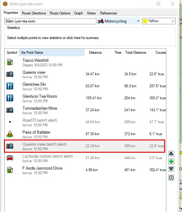

It is definitely related to 'Queens View'. It is added twice to the route as a via point (Alerting)
If i change the 2nd to Shaping (Non Alerting) the route loads in the XT, but the 2nd occurence of 'Queens view' is missing.
I would suggest working your way around this. Maybe rename the Second to 'King Charles View?' (Humour intended)

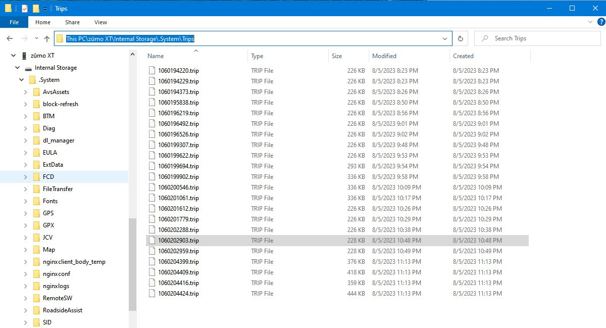

EDIT: After I tested your route I wanted to clean my XT. I found that there were '.trip' files in the '.System' directory, but none of them were visible in the trip planner. I bet your XT also has some leftover .trip files. I would clean them up.

I felt I had to clarify my reply from yesterday with an example. If you take these steps, the route will load in the XT.
1) Duplicate the Waypoint 'Queens View', and rename it to 'Queens view Return'. (Any different name will do)
2) Delete the second Via point named 'Queens view' from the route.
3) Substitute it with the newly created waypoint.
See my attached GPX.
Conclusion: It might be as simple as "You cannot have multiple Via points in a route with the same name."

Many thanks for your help with this, I put a shaping point in after deleting one of the "queens view" via points from the route, and all is good. :)
