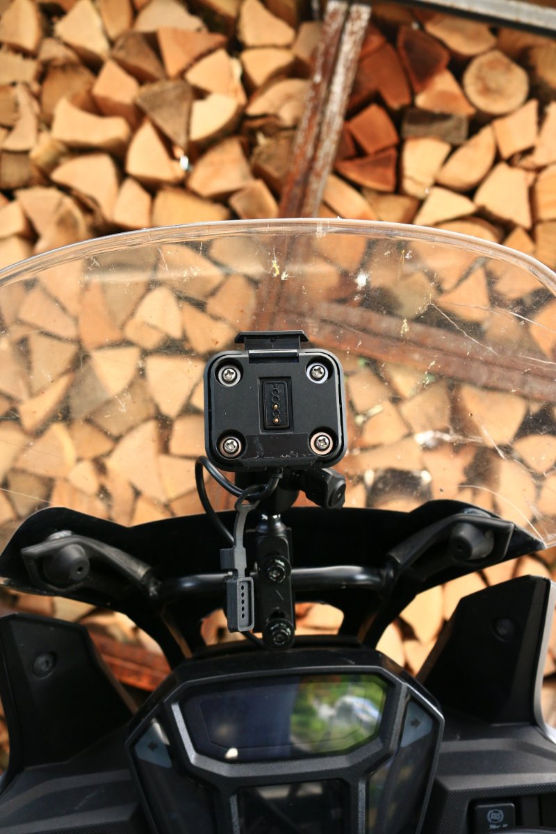

I have the mount center above the dash of the bike and nicely tucked in behind the windscreen.

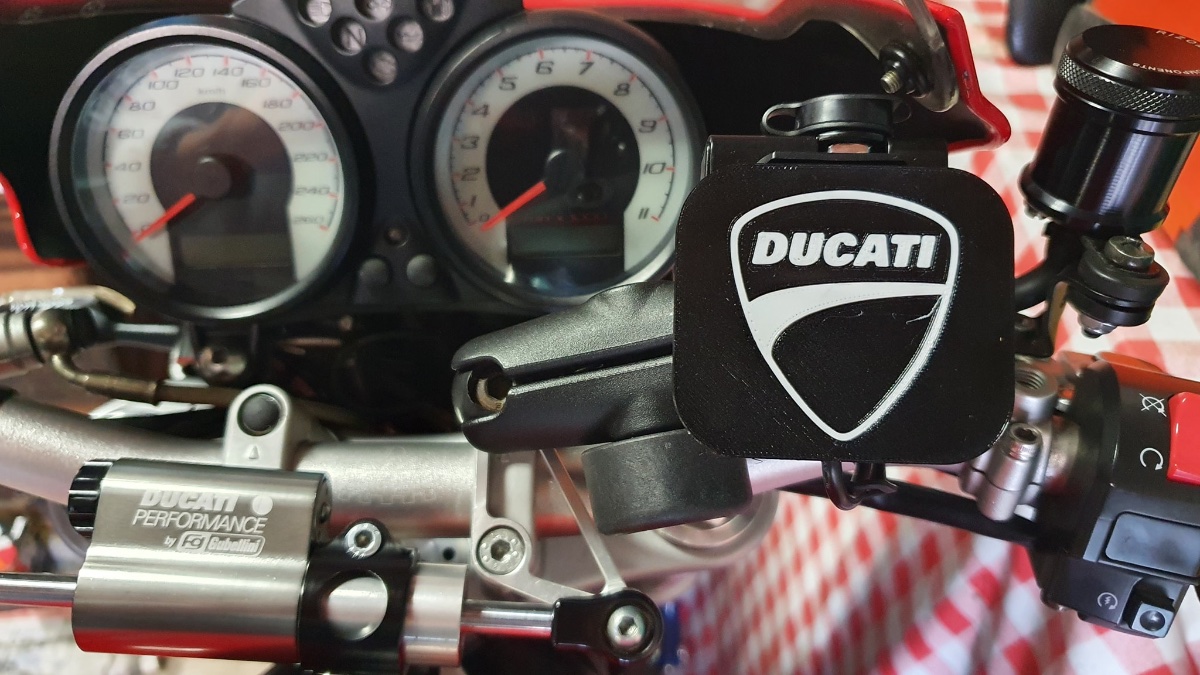

Has anyone made an alternative mount cover more in line with that of the 595/590?
simoncrewe
Posts: 207
Has liked: 47 times
Been liked: 38 times
Re: WARNING - Garmin Zumo XT hot-shoe connector weakness
Post by simoncrewe »
axamax wrote: Wed Jul 01, 2020 2:50 pm Has anyone made an alternative mount cover more in line with that of the 595/590?
Here you go https://www.thingiverse.com/thing:4208663 The Dutch guys on their Facebook page have been making these.
This is what Gamin should have built from the start.
Since I only use my Garmin Zumo XT when I am touring, I have now "folded down" the cradle to make sure it is as much tucked away as much as possible behind my windshield when not in use.

There is also Bert Klein, a Dutch guy who printing covers on demand, normally black or with logo. Find him @ Dutch XT facebook, or [email protected]
