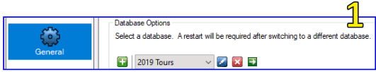

In the Edit Menu, click Options and then click the ‘General’ gear icon. Pic 1

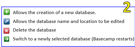

The ‘Database Options’ section shows the icons that allow the user to perform the actions shown in Pic 2. The drop down list displays a list of all of the database that it knows about - ie the ones that you have used.

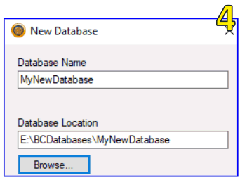

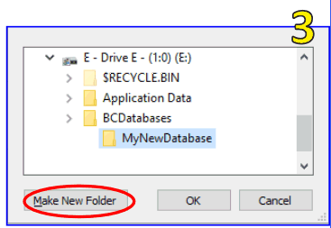

So I navigate to that and select ‘Make a New Folder’, and I name the folder Pic 3 the same as my Database. Pic 4 That way I know which Windows Folder relates to which database.
