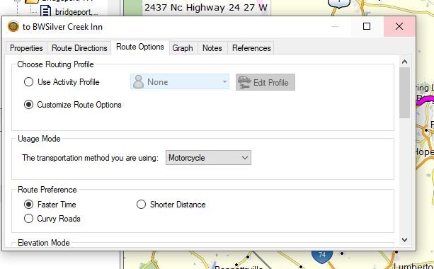

Route Properties.JPG (57.6 KiB) Viewed 10682 times
Customize Route Options.JPG (41.36 KiB) Viewed 10682 times
Another thing- when you make your route in Base Camp, select "Customize Route Options". Do this by double clicking the route name to open the Route Properties box. Click the "Route Options" tab.
Then tick the "Customize Route Options" box and fill out the info below that.
This may help to specify to your gps device to use custom selected parameters, kind of overriding the generic Base Camp or device ones. It helps immensely on the 595 model.
