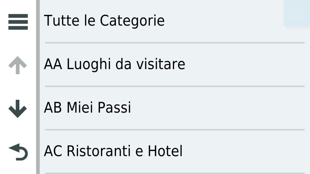

Hi to all.
I look this post and i understend how to save a POI list in the nav.
But i have a question.
When i go to
"Custom POI" i don't have any "Categories" , i see only the name list of the poi imported.
For now i imported only 1 File, but i have other File and i'd like find the POI sorted by Category.
For example Camping, Mountain Pass.
How can i do this, depend about the .CSV file.
The .CSV file i used, is a .GPX file converted in .CSV
Thank you

The way to have Custom POIs in categories on your GPS starts with organizing the POIs into separate files on your computer before using POI Loader to compile the POI file for your device, then using POI Loader to compile the entire file structure.
By way of example: I have a folder on my computer I named POIs. Within that folder I have subfolders for my POI categories. I currently have 22 subfolders representing my categories. Each subfolder contain one or more gpx files. So for example, I have a subfolder for Food which contains 20 gpx files of various lists - BBQ, Diners Drive-Ins & Dives, Classic Diners, Lobster Pounds etc. Once, I have the files set up I use POI Loader and load my main POI folder. By organizing the files this way I can search any individual file or larger category on the device
So to search for say Lobster Pounds, I would tap Where To, then Custom Pois. A list of Categories comes up representing the subfolders. From that I would scroll down and tap Food which brings up another list of the files within that Category from which I would scroll down and select Lobster Pounds.
I believe that one level of subfolder and one level of files are the limit of what POI Loader will recognize.

Perfect :D . This is what i need.
Thank you.
Now i'm looking how to manage the POI with Basecamp. I have some list to adjust because the .GPX file that i have exported from Osmand is not compatible.
