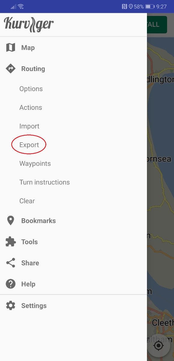

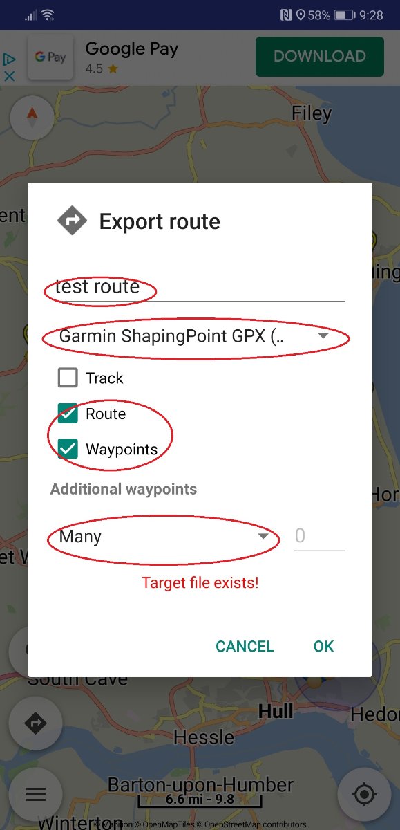

Simply create your route then click the menu button >> Routing. Then click on Export. Then name the route if you so wish for ease Click on the drop down menu where it says Kurviger (*.kurviger) and select Garmin ShapingPoint GPX (*.gpx) I ticked route and waypoints then under additional waypoints select many and click OK. The route is now exported and in the folder.
