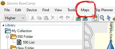

by MSTOCK27370
jack777 wrote: Thu Sep 17, 2020 5:06 am
I've downloaded a couple of country maps but when I set up a route in Basecamp it shows as straight lines, like the Global map. Any suggestions as to what I've done wrong? Thanks Jack
In BaseCamp, go to the "Maps" menu. You should see the new map that you downloaded. Make sure that the map is selected, not the Global Map.
- Capture.JPG (16.25 KiB) Viewed 17354 times
