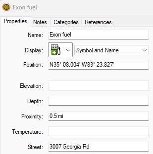

Regarding an audible warning to occur 0.5 miles in advance of this WayPoint (see attachment), I perform the following:
Settings
Driver Assistance
Proximity Alerts
Audio
Single Tone or Continuous Tone.
I tried Continuous Tone but one-half mile of tones was overkill.
I tried Single Tone, and I mean I really focused on hearing the single tone, but I never heard the tone.
I typically listen to music so I expected an interruption in my music in order to hear the Single Tone but to no avail.
Anyone have any advice for the successful use of Proximity Alerts.
I thank you in advance.

Hi,
How do you load this way point on the XT?
If you export from BaseCamp to GPX and just transfer that GPX, you will find it on the XT in Saved, or Favourites (Depending on the language) Then you will not get an alert.
To get alerts you must convert the GPX to a GPI file and load it on the XT. There is a Garmin program POIloader that can create and load the .GPI. But there are others, like TripManager, that can do it also. After succesful transfer you will find the converted waypoint on the XT under 'Categories' / 'Custom POIs'

Thank you very much Peabody. The clue about the double-bong similar to school warnings is very helpful. I do hear the double-bong for schools.
After I wrote the original email I did happed upon a volume control for proximity and it was set at about 75% so I bumped it up to 100% then took the XT on a trial run in my car with no radio or extraneous noises to drown out the double-bong, but still to no avail. Maybe someone else has more clues.
