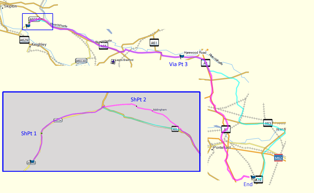

The route map:
Norton Test Route Overview Map.png (220.93 KiB) Not viewed yet
The route has ShPt1 just after the start. This is there purely so that I can press skip to force the route to recaclulate. This seems to be one way that RUT behaviour can be triggered.
ShPt2 is placed on a road that I do not intend to travel. Instead of taking the 2nd exit at the rouandabout to ShPt2, I will take the third exit (UK, traveling clockwise around roundabouts) - ie heading East.
Via Point 3 merely forces the route away from a fast route along the M62 to the south of the map. I will pass through this point.
The only other point is the End Point. The Magenta route is the way Basecamp has planned it and is the way that the XT2 calculates it. I know that it will want to make me take the A1. It is faster and more direct. Nevertheless, I will take the route shown by the cyan (light blue) line.
