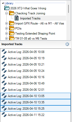

- Rather than relying on the automatically recorded tracks - in /GPX/CurrentTrackLog.gpx and in the Archive Subfolder - you can start your own recording. It will record both simultaneously. On the main screen there is a Track Recorder icon. Click that and then Start. It will keep recording until you select stop fromt he same screen. The Track Recorded icon on the main screen shows a little blue symbol to show that a recording is in progress. When you select 'Stop' you have to save it and give it a name. That gpx file can be found in the same location as the automatically recorded tracks.
- Basecamp has a facilty to deal with this. It is quite intelligent too. Connect your XT2 to BAsecamp with the USB cable. (Get into the habit of unplugging the lead at the computer rather than the back of the Zumo - it saves wear and tear on the XT2 socket). When you have dismissed the message that says that XT2 is not officially supported by Basecamp, then import CurrentTrackLog.gpx into Basecamp:
* Create a new folder and a new list within that folder.
* Select the new list that you have just created
* Select File / Import Into ... (your newly created list)
* Navigate to Zumo XT2 / Internal Storage in the dialog box that opens
* Select CurrentTrackLog.gpx
You will see a list that looks like this:
This should be in date and time order, but if not, you can click the gear icon to the right hand side and ask it to sort by name in either descending or ascending order. The date is deliberately formatted year-month-day time so that sorting the name puts it into the correct sequential order.
Multi-select the day and times of the sections that you want to join together. (Click the first, hold down the shift key and click the last to select a number of items). The image above shows that I have Select all track logs for 10 April 2026.
Move the mouse pointer to any one of the higlighted items, and click the right hand button.
From the pop-up menu, select 'Join the Selected Tracks'
It gives you the option of either keeping the original tracklog files, or deleting them. That is up to you. These are copies of the ones that are in currenttracklog.gpx. They are not the originals.
What is clever about it is that it uses the data and time of the track points to put them in the correct order. So even if all of the track logs were jumbled up - you would still end up with all of the pieces of the track joined together.
Ditto if I selected all of the logs across a number of dates. All of the points would be ordered sequentially by data and time. - If you just want to see them on the screen you can use the folder / list structrue of Basecamp. Select the folder and it displays all of the items that are inthat folder - including the contents of all of the lists. Select one list within a folder it shows only the contents of the list.
Select one of a number of tracks in the same list, it will show all of the tracks, but the currently selcted track will be in a darker colour.
