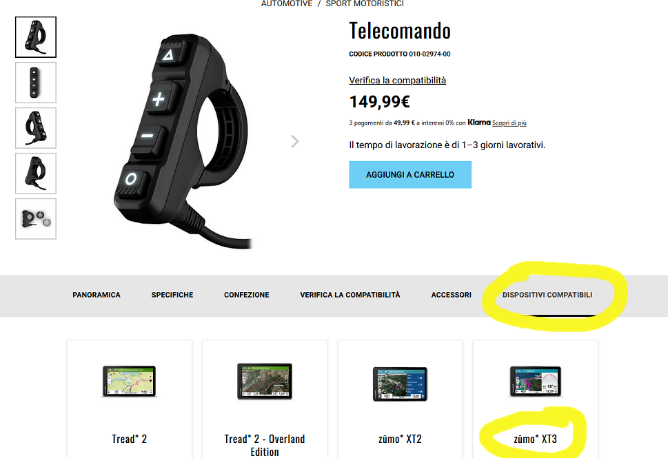

are you sure the handlebar control is not supported ? ( or am I not understanding what you wrote, my English is not so good ...)
here is a picture from Italian Garmin website
- Screenshot 2026-02-20 230213.png (217.3 KiB) Viewed 2224 times
Re: Help from Anyone Buying an XT3
No I'm not sure - it just wasn't listed on the English site - but it uses the same cable Y adaptor - so I reckoned that they would probably update the software at a later date. Actually - I looked at the XT3 site for accessories. I didn't look at the controller site for compatable Zumos.....
No its not listed on the UK site yet.
Damn. I though I had a good reason not to be tempted....

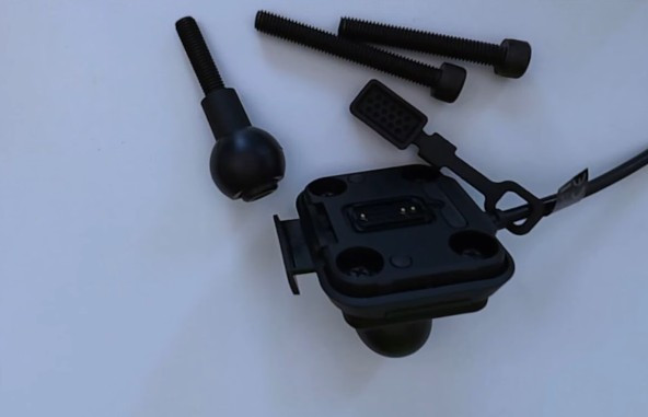

I disagree. In the first review of the XT3, a three-pin cable is visible at 9:18.jfheath wrote: Sun Feb 22, 2026 7:22 am The adapter cable comes with a new mount with 5 of the 6 pin locations populated.
2 are +12v, 1 is earth, 2 are for data signals. ...
- _a_Screenshot 2026-02-22 100032.jpg (28.65 KiB) Viewed 2135 times
BMW R1200 ST
That's OK - you can disagree - but my statement is correct. What you are showing seems to be the cable that is provided with the XT3 - it looks to be the same as the one that is supplied with the XT2.Francis wrote: Sun Feb 22, 2026 9:01 amI disagree. In the first review of the XT3, a three-pin cable is visible at 9:18.jfheath wrote: Sun Feb 22, 2026 7:22 am The adapter cable comes with a new mount with 5 of the 6 pin locations populated.
If you want the handlebar controller, or the group ride radio (or both), you need a different cable that replaces that one. It is called the "Handlebar Controller and Group Ride Tracker Y-Adapter Kit" https://www.garmin.com/en-GB/p/1933581/pn/010-13985-00/ . I referred to is as ‘the adaptor cable’ and it is a complete replacement for the original cable - and is provided complete with the cradle that has those extra pins.
Garmin got this badly wrong when the handlebar controller came out. But you were around when we were trying to work out how the controller worked with the cables that Garmin said were needed. They were wrong and shortly after they introduced this new cable. Nov 2024.
You might remember that Garmin were suggesting that two new cables were required - a new power cable and a new adapter cable.
I made sure that this was all documented in the discussion thread that we had at the time.
viewtopic.php?t=3089&hilit=handlebar+controller
I think that you were going to modify the cables that you had. I thrashed it out with Garmin and made sure that they knew that the information that they were providing was wrong. I sent my cables back and ordered the new one. I thought I'd get two, 'cos I was expecting another bike - which didn't happen. It's here untouched in my desk drawers - waiting for a pin to go south on the fitted one.
Yes, you need to buy a different cable for the XT3, with a branch for accessories. This cable has 5 pins.
However, the cable supplied in the box with the XT3 has only 3 pins and you cannot connect a remote control to it. This is the same mistake from Garmin as with the XT2, it makes the purchase of a remote control more expensive.
The 5-pin cable in the kit has the Tread 2 and does not require additional costs to expand with a remote control.
Why does Garmin supply it with the Tread 2 but not with the XT3?
