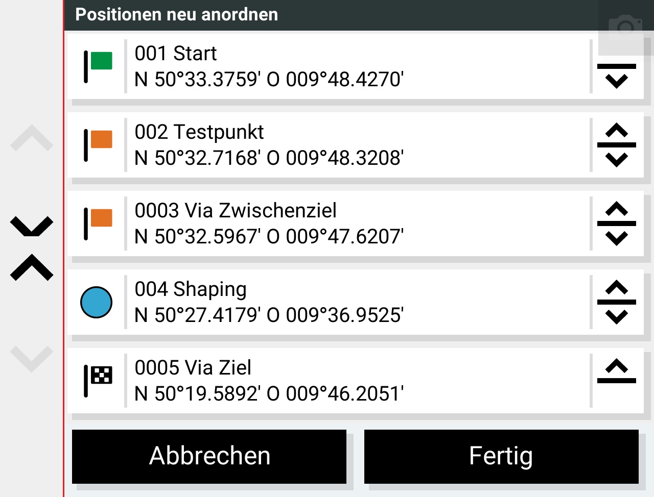

My test route consists of 5 waypoints. One of them (4) is a shaping point; the others are via points. The first two route segments use Faster Time, and the last segment (which includes the shaping point) uses Adventurous Routing.
I did not enable the global “Avoid Highways” option, because I wanted to be able to use highways on specific route segments.

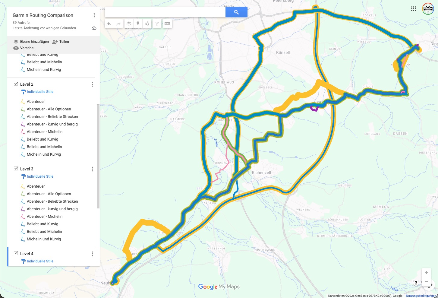

When I originally did my comparison, I observed the following behavior:
• Adventurous Level 1: Almost identical to Faster Time, using highways
• Adventurous Level 2: Already avoids highways completely
• Adventurous Level 3: Almost identical to Level 2
• Adventurous Level 4: Adds a few more curves, but mostly unnecessary ones

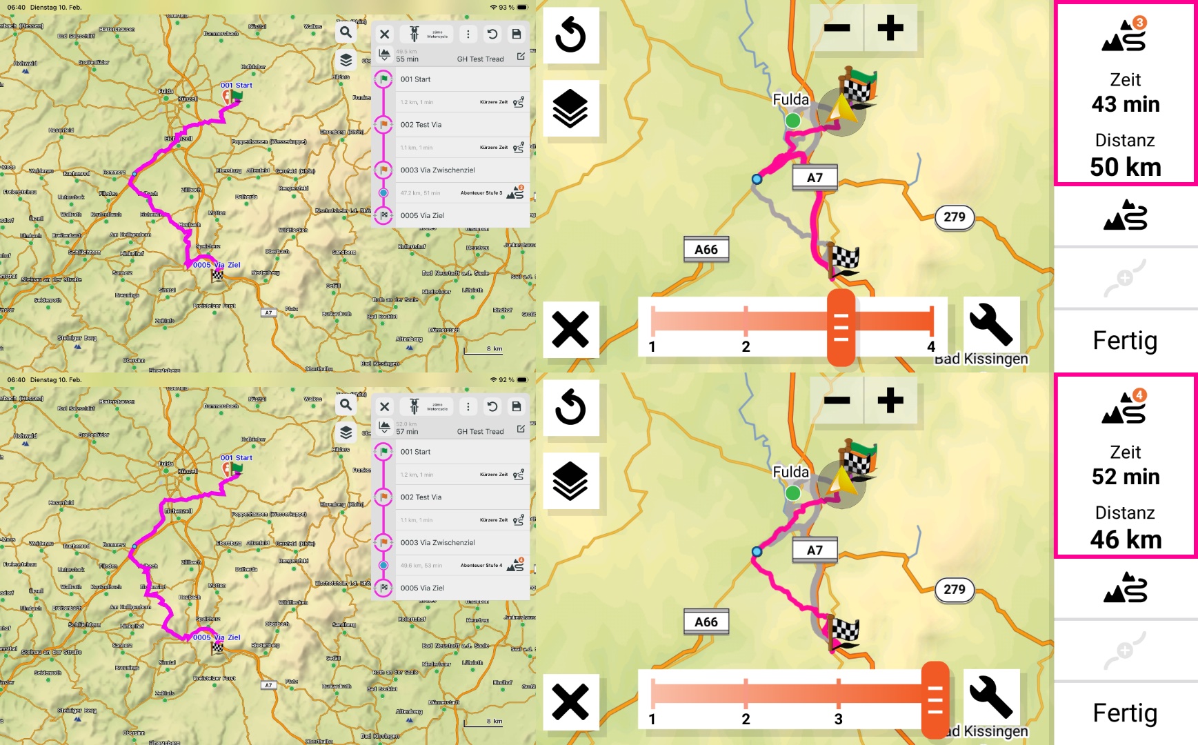

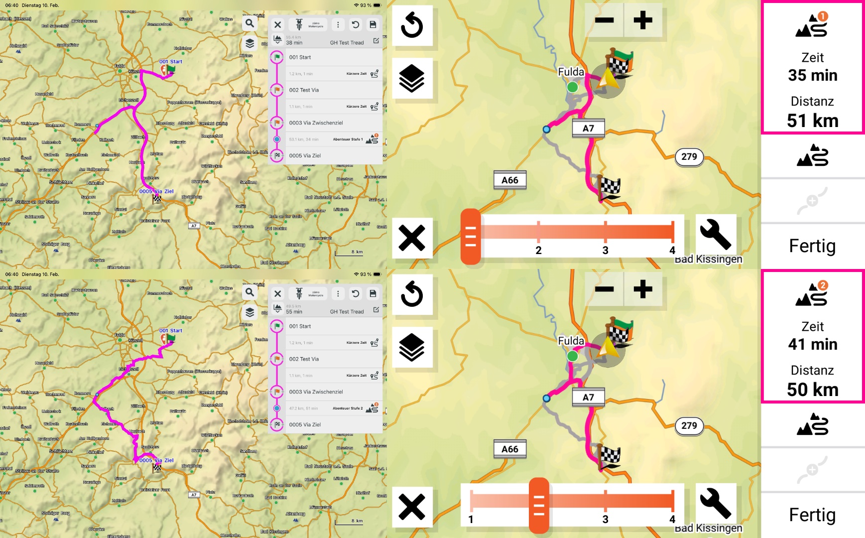

For reference, I’ve added screenshots from the Tread app on my iPad, which still show the behavior I observed on my XT2 at the beginning of January.

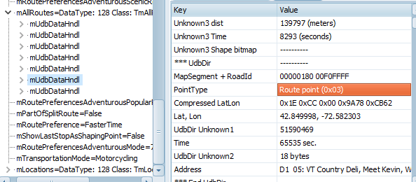

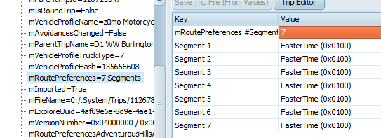

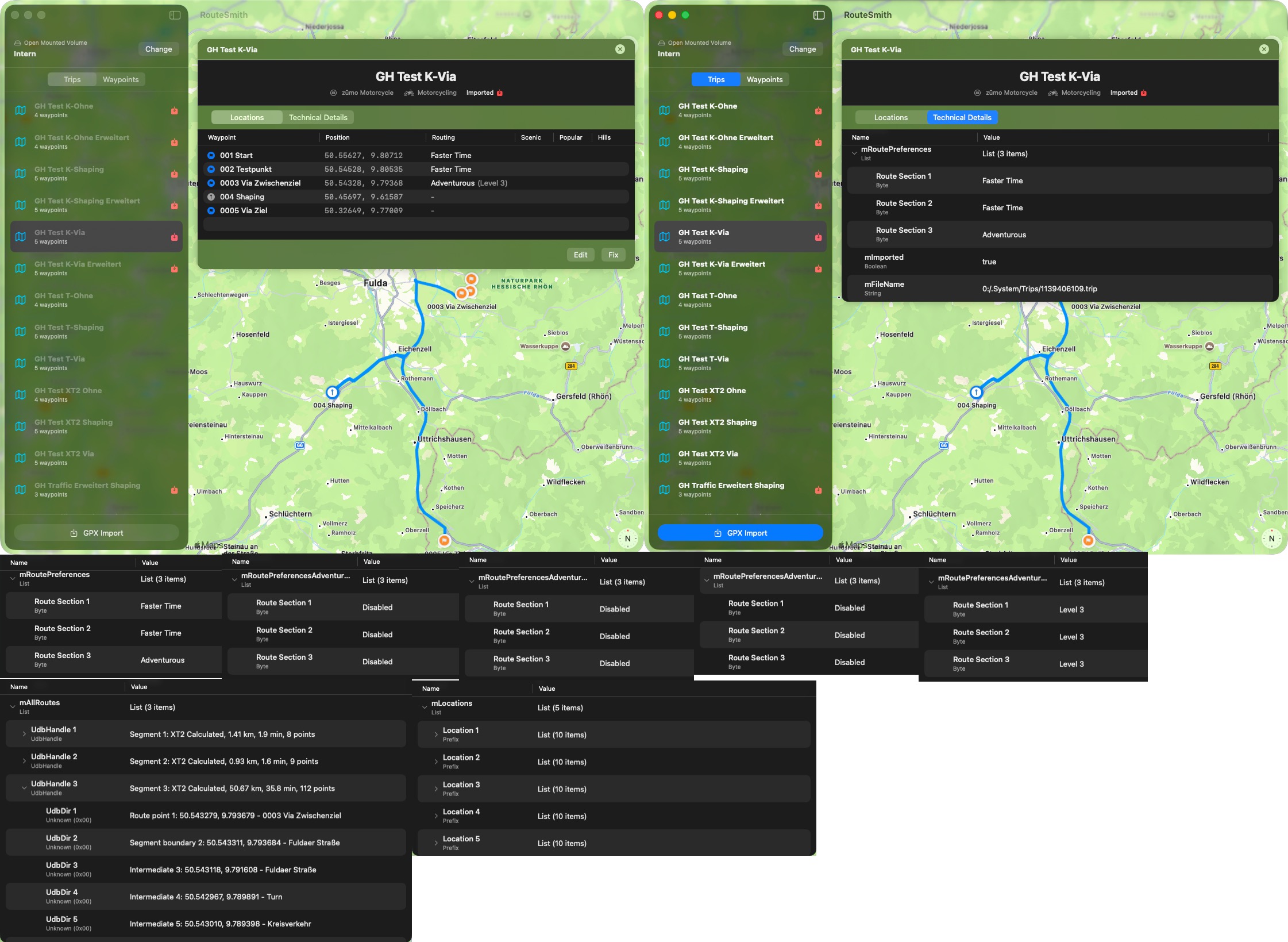

What I find especially strange is that I’m seeing two different routing behaviors within a single route segment, even though only one Adventurous level can be selected for that segment.
I'm not sure how I could verify what you are seeing but I can share some thoughts that might help you investigate.

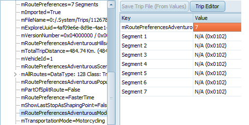

If you open the .trip file on the XT2 in Trip Manager, you can verify the XT2's view of segments and settings. It will show you:
the route segments and routing preferences per segment,
the adventurous level when applicable,
and what each segment is made up of.
Segment Content.png (45.61 KiB) Viewed 636 times
Segments are normally between via points but maybe your last segment became 2 segments somehow - via to shaping and shaping to last via?

... screenshots from the Tread app ...
If you allow the Tread App to sync, it introduces another set of variables. When Tread syncs, it can make significant changes to shaping points.

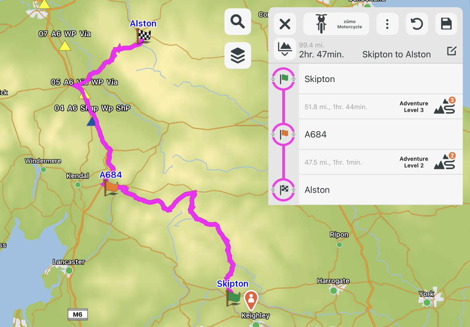

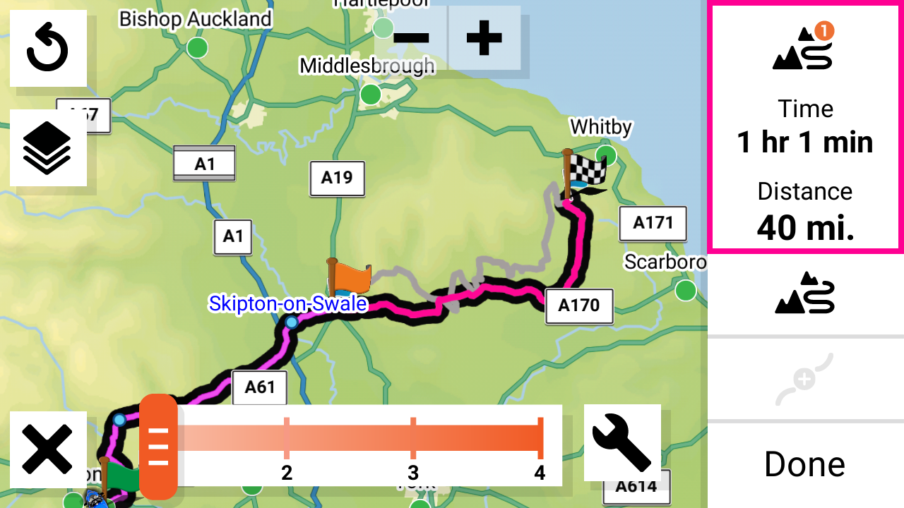

Nothing much to add to what @smfollen said except:
When you load a route with Adventurous routing, the value of the slider is not the level that is set for the route segment. The only value that you can rely on is the one in the display for the segement on the right hand side of the screen - a small white number in an orange circle.
I notice that your screenshots show the slider in the position that matches the number in the circle - that isn't my experience - although it is a little while since I started to look into this. I decided that I hadn't got a clue what it was doing and I needed to find a couple of places in the local area for which the stanav would calculate 4 different routes depending on the settings in the XT2. So then I would know from the roads that it used, which setting it had adopted.
Only then could I work out what takes priority. Is it the fact that I have chose level 4, or is it the fact that I have Michelin Maps as a routing preference.
I don't think that you can set an activity number to anything but a whole segment - from what I have seen, the routing as a tag that is added immedidately after a Via Point is declared in the GPX file.
I've got two A5 notebooks here of routes with different settings and what data was retained in different circumstances. One of the last entries was that some segments had changed because the Tread synch had got hold of the route and altered it. That might have happened before and I didn't notice. I needed a better testing model and eliminate what Tread was doing because that behaviour rendered all of my tetsing useless ! So that became another investigation, and it was about this time that FrankB announced that TripManager wouldn't work with the XT2 - so I became the XT2 user and spent the time on that and on reporting to Gramin the influence that Tread was having on routes and route points.
I never came back to it.
I haven't got an answer for you. I decided that I would never want to use what Garmin decides is a category for adventurous routing (except I agree that Faster routes always seem to be identical to level 1 routes). I have little interest in using the routes that other Moto users use. And Michelin scenic routes - I'm unsure of what criteria they use, cos there are a few near me that are 'scenic', but I know of better ones that would fall into that category (for me) that are not lined in Michelin's green.

smfollen wrote: Tue Feb 10, 2026 3:11 pm I'm not sure how I could verify what you are seeing but I can share some thoughts that might help you investigate.
Continously having an eye on that, but not with the TripManager ... the Dark Side of the Force - remember?
And all of the info look as aspected - but not the route.

smfollen wrote: Tue Feb 10, 2026 3:11 pm If you allow the Tread App to sync, it introduces another set of variables. When Tread syncs, it can make significant changes to shaping points.
jfheath wrote: Tue Feb 10, 2026 3:49 pm I've got two A5 notebooks here of routes with different settings and what data was retained in different circumstances. One of the last entries was that some segments had changed because the Tread synch had got hold of the route and altered it. That might have happened before and I didn't notice. I needed a better testing model and eliminate what Tread was doing because that behaviour rendered all of my tetsing useless ! So that became another investigation, and it was about this time that FrankB announced that TripManager wouldn't work with the XT2 - so I became the XT2 user and spent the time on that and on reporting to Gramin the influence that Tread was having on routes and route points.
proofresistant wrote: Tue Feb 10, 2026 4:38 pm I'll just give you a quick answer because I don't have much time right now :(
Please note:
  • The Tread app manipulates routes, especially shaping points
  • The Tread app can often lead to endless loops during synchronization
  • The Tread app calculates routes differently than the zumo XT2
  • When the Tread app is also in action, it makes it unnecessarily difficult to reproduce comparable results
I'm well aware of this. This is why I call Tread/Explore the root of all evil. :twisted:
I'm using the Tread App for traffic and weather info, but Explore and any sync is disabled. So no issues with shaping points moving around and routes get screwed up.

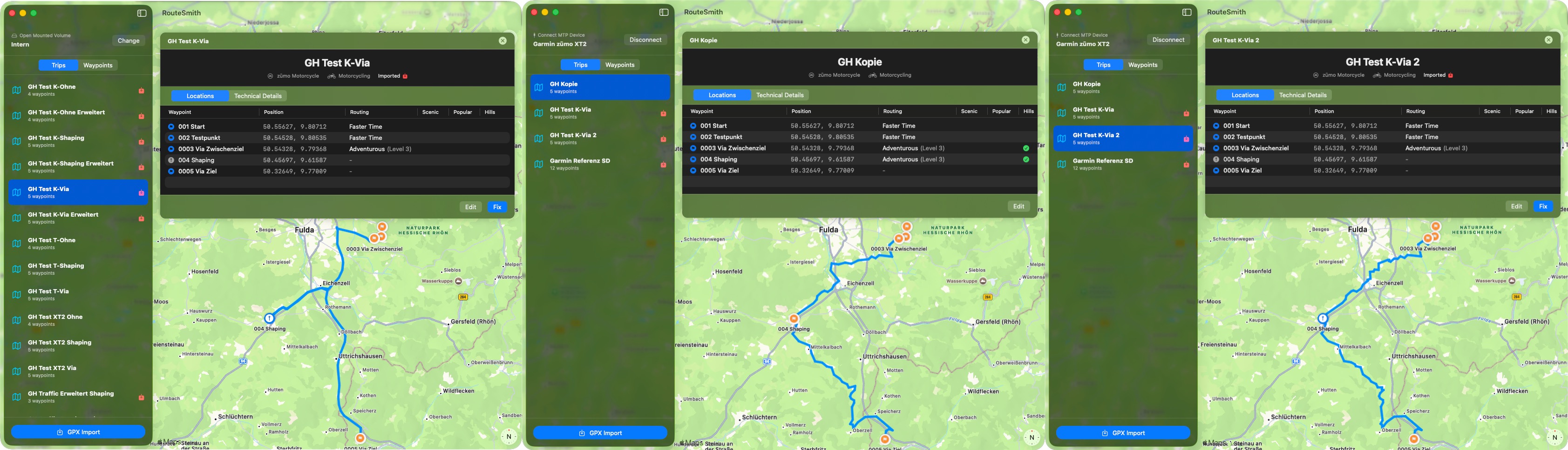

Menthile the situation got even more strange.
Trying to understand the issue I created a copy of the route (on device).
On the copy of the route I turned the shaping point in the adventurous segment into a via point.
This turned the segment into two segments. Both with adventurous routing level 3, and immediately the route is like it was when I started in January.
Then I imported the test route with the shaping point again, an now it is also calculated correct.
I don't get it.

rhoenschrat wrote: Tue Feb 10, 2026 7:37 pm I'm well aware of this. This is why I call Tread/Explore the root of all evil. :twisted:
OK, but “any sync is disabled” isn't that easy to do retrospectively, is it?
As far as I know, you're not allowed to activate the Explore connection when installing the app.
https://www.rhoenschrat.de/routesmith/f ... vior-2.jpg
https://www.rhoenschrat.de/routesmith/f ... vior-3.jpg
Anyway, based on your pictures, I suspected Tread App sync might be activated/involved.

In my experience, I can set the adventure level per segment in the Tread app, but on the XT2, every change is applied to the entire route. Has that been your experience as well?
In my opinion, the Kurviger app is much easier to use, especially when it comes to adventure. Export it as a track, and you're all set.
Re: Changed adventurous behavior on XT2
vigo wrote: Sun Feb 15, 2026 8:57 am
Tracks work for a lot of people, but I am not a fan of using tracks to navigate - I like to have the estimated time of arrival at the next 'pit-stop' particularly for my pillion. Also when navigating a track, if you deviate, that can be subject to RUT behaviour as well. I like to have the track displayed under my route so that I can see where the XT/XT2 has changed it - and I can choose to follow whichever I want. Typically, on a well prepared route, the Zumo will recalculate the current section to head the way I decided to travel.
vigo wrote: Sun Feb 15, 2026 8:57 am In my experience, I can set the adventure level per segment in the Tread app, but on the XT2, every change is applied to the entire route. Has that been your experience as well?
I can see why you might think that - but no. It applies it only to the seqment being edited. The problem is that when you select a segment to edit, the sliding scale shows the last value that was entered.
If you synch the route with the Tread App - not something that I recommend, but I do it occasionally - the Tread App on your phone or ipad will show you the setting for each segment. (A segment is a part of the track bounded by a Via Point at each end).
****Wrong ****Also the route planner screen on the XT2 will reveal the level as a tiny digit in an orange circle.****Wrong !!
I'm looking for some screen shots. I'll post some later. I found one - attached below. However - I was wrong - when you open up the Trip Planner App and select an existing segment, it shows the screen below, but the digit represent the current setting of the slider, not the setting assigned to that segment.
However on my phone and Ipad you get the entire route in a table on the right hand side and it shows the level assigned to each segment. Select the segment from the table to edit the setting. Click the image to zoom in to a full sized version.
Screenshot 2026-02-15 at 10.04.10.png (1.07 MiB) Viewed 465 times
