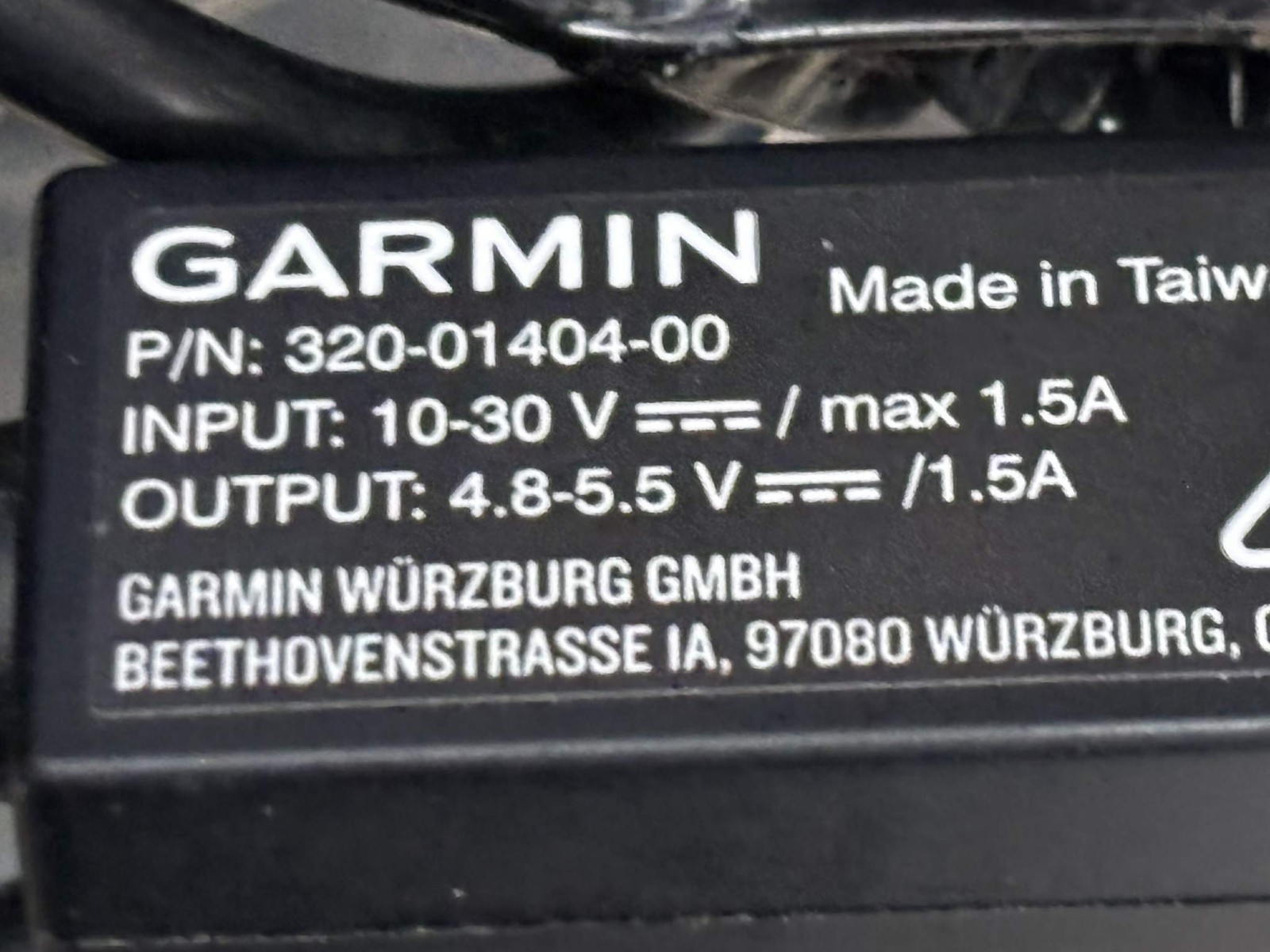

That is a good point. The device in the middle of the OEM cable shows this.
zūmo XT Motorcycle Power Cable
Input: 10-30V, 1.5A (max)
Output: 4.8-5.5V, 1.5A
For current draw on motorcycle cable when zūmo XT is not mounted, see Current Draw of the zūmo XT Motorcycle Power Cable.

- Garmin 320-01404-00.JPEG (266.15 KiB) Viewed 668 times

The XT will not be able to negotiate power delivery with a USB-C charging port, so I would expect the port to deliver only 0.5 amp of current at 5V. And even that will require resistors to ground on the CC pins of the cable before the charging port will deliver any power at all.
The XT needs at least 1.3 amps for full brightness with a fully charged internal battery.
I think you need to use a different method to power your Zumo.
