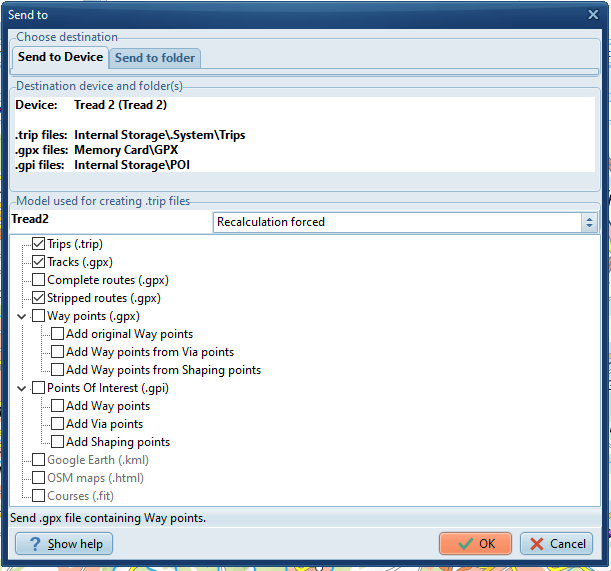

It looks like routes and GPX files from Kurviger https://kurviger.com/ can be transferred with TripManager also :)
At least in principle; I have currently tested it with my Tread 2 device.
But i noticed that only the option with recalculation actually makes sense.
The other options i didn'd testet, because i didn't found ghost points in the GPX Files from Kurviger and require recalculation.
In my opinion, it probably also makes sense to have routes from other sources recalculated in the device :idea:
I would recommend checking the calculation mode for route in the device, because although I used “Fast” in Kurviger, but “Adventurous” (without the second additional attribute) i found in the GPX file.
Then I noticed a "suboptimal feature".
Kurviger can also export the track in addition to the route in the GPX file.
However, the track then has the same name as the route.
If I now select the route and track from the GPX file during TM transfer and I want to transfer both the stripped route and the track, “only” the track of the route (which unfortunately is not a track due to missing waypoints) is transferred and the “real” track with the same name is missing.
Here is my question for @FrankB:
Could an option be added to TripManager so that if the “real” track name in the destination GPX “Tracks_*.gpx” is already used by the ‘route’ track name, the real track will saved with a suffix (e.g., may ” 2") in the GPX olso?
By the way, same Names for Route and Trip can be content from BC also ;-)
TM used SendTo Options.png (63.68 KiB) Viewed 626 times

proofresistant wrote: Fri Jan 09, 2026 10:08 pm Here is my question for @FrankB:
I will look into it. I agree that it is not useful to send a track with no <trkpt>, while there is a complete track in the original GPX.
In this case I would also prefer the track, and not the route. Would that be a solution, if TM also prefers the track?
Btw: For stripped routes the route is always taken.
An alternative, that can only be used when sending to the device, is to send the Complete GPX.

Yes, if so, preferably send the track, that would also be OK.
Then, I don't really use/need the complete route as GPX.
When I import GPX into the device, I somehow prefer the stripped route, I mean stripped routes are imported faster and have to/should be recalculated in the device anyway.
